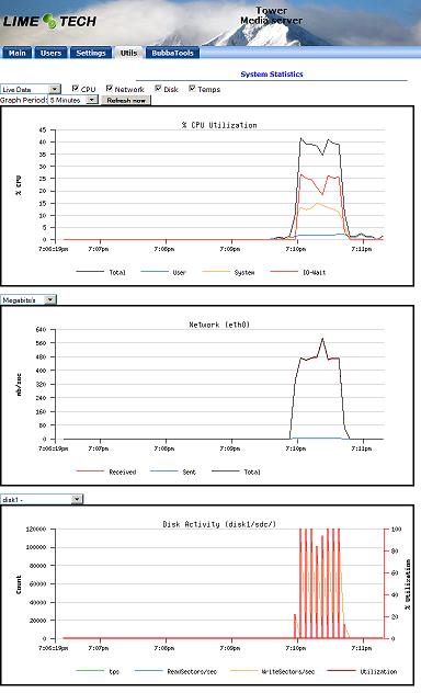

Works like a champ on my bench box.... including r8169.
Samba throughput (large file copy) is improved 15 to 20%.
Graph is 2.5GB file copy to unprotected disk (no parity).... solid 480 mbps.
Thanks!
Is this under SMB2 or SMB1?
