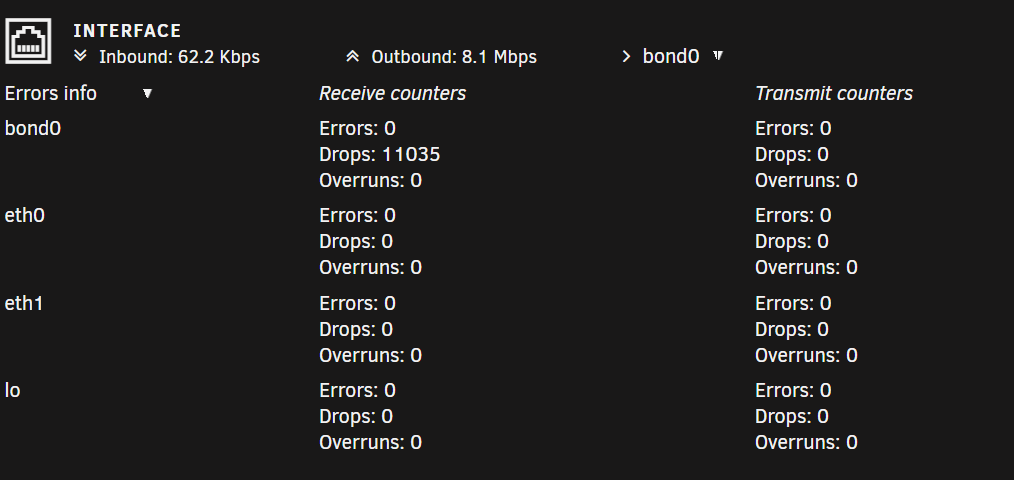

It seems like sometimes I get intermittent drops in accessing the webUI and the receive drop counter just keeps on going up. Within a few days it went to 500k drops. Any help is appreciated. I just upgraded my server, new MB, CPU, RAM, HBA, so hopefully theres nothing seriously wrong here.
The image of the drops is within 20 min.

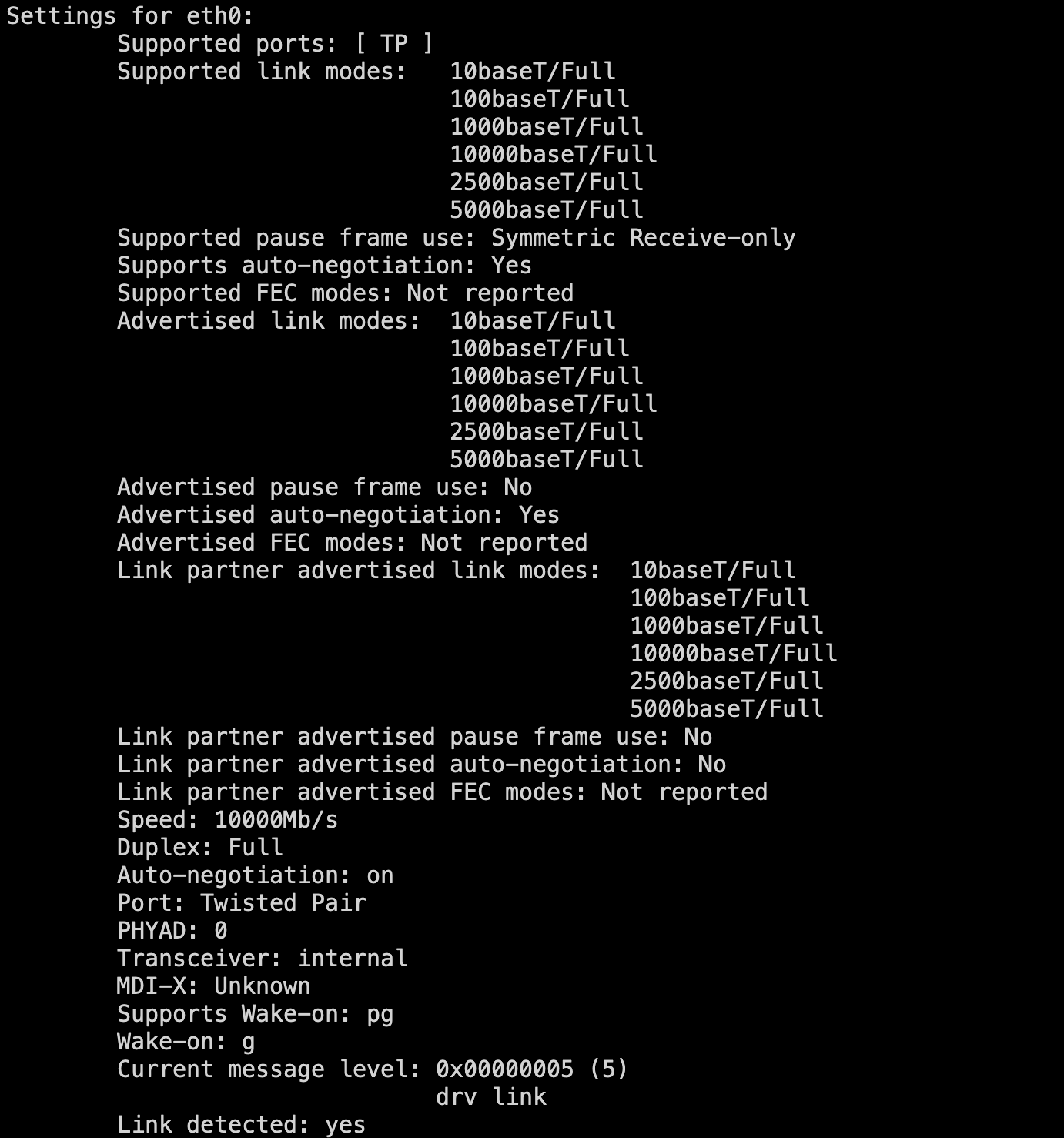

Turn on FLOW CONTROL on BOTH sides!
Your Unraid is set to "Receive only", your Switch to "none". This will very likely end up in lost packets, timeouts and retransmissions.
Thanks for the response! I just turned it on. I saw this post, where he says flow control being on causes issues?

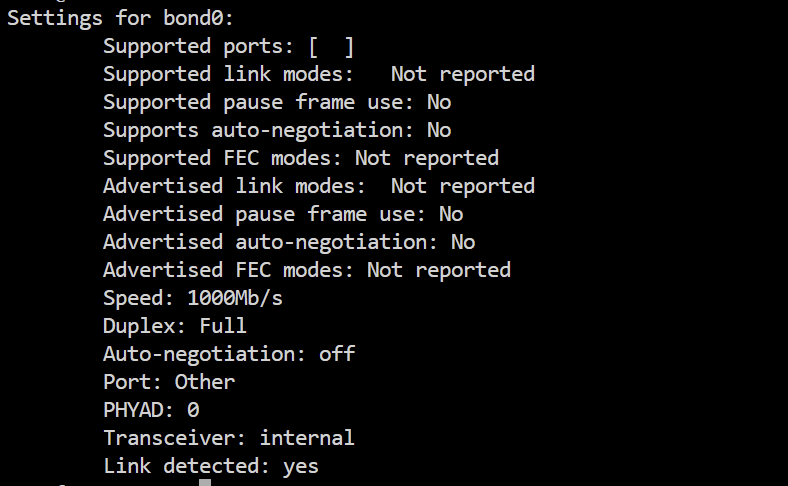

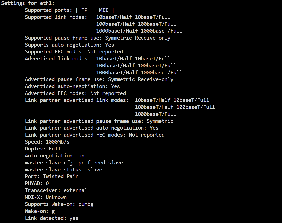

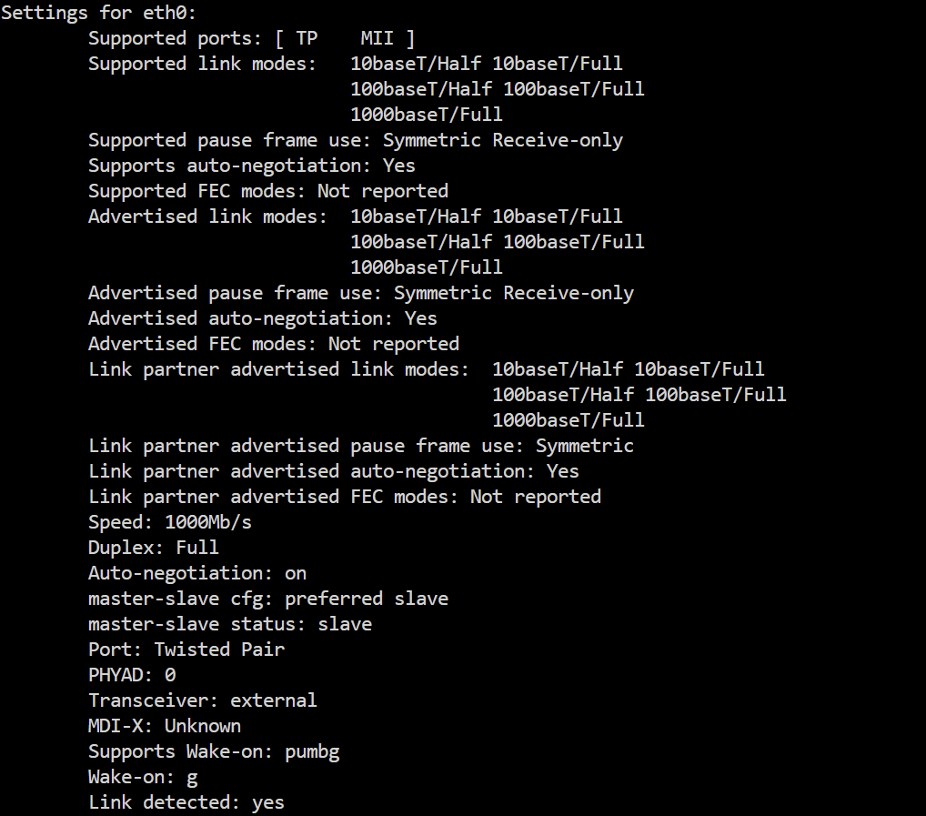

Also have drop packets on bond0 (after macvlan issue was fixed ,so goes back to bond0 ... in 6.12.x)
changed cables also one nic only not bond0 ,but still have many drops every sec ...

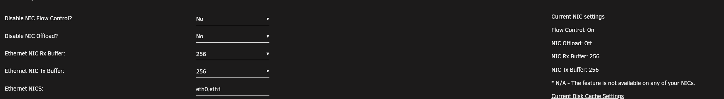

Disable/anable NIC Flow Control does not change anything
Out of curiosity I played with rx/tx buffer sizes which also has no effect

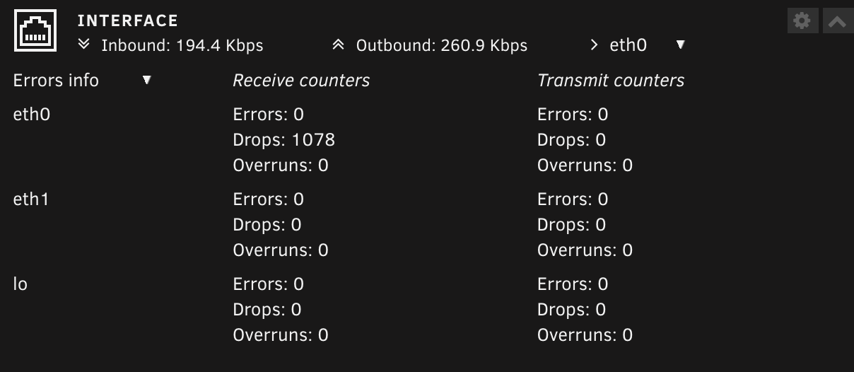

eth1 is not connected
1598017295_Unraideth0.thumb.jpg.59f0e87ced42d55c62c9bd4f8daf6590.jpg1783874198_Unraideth0_interface.jpg.bbdbdb955f61a0757c154a6bfdefd21b.jpg
nasng-diagnostics-20240221-1632.zip
