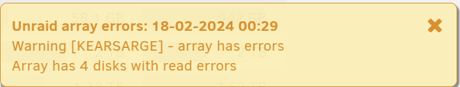

Read errors on disks when sync parity
I add a parity drive and start to sync parity, after a few minutes,it reports an error. could someone tell me why this happened?Thanks a lot

The diagnostics show disks 2, 3, 4 and 5 dropped offline.   Is there anything they share?   Is perhaps the PSU struggling to power that many stoves?
Could also be an issue with the onboard SATA controller, it was quite common some time ago with Ryzen boards during heavy load, not so common with more recent kernels.
They use the SATA on the MB, and the parity disk use pcie-sata card
so is this a software(driver) issue or a hardware issue? How can i solve it? help me please, thank you
If it keeps happening recommend using an addon controller, of a different board.
