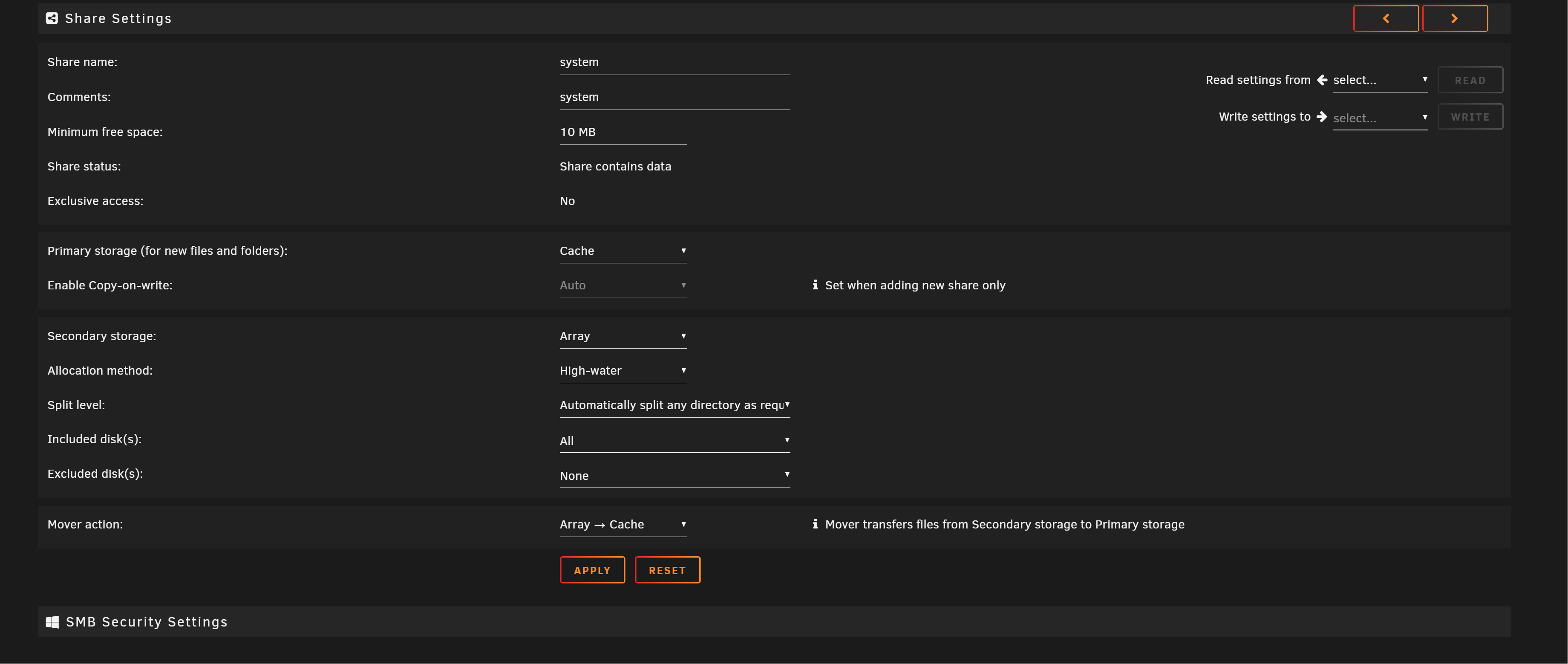

I'm very confused by these new settings as far as the shares goes is this how im suppose to have it now
im trying to keep 4 things on cache appdata,system,domains.isos

Those settings are correct for Giles to end up on the cache.    You need to disable the docker and VM services under settings and then run mover to transfer files to the cache.   After doing that you can re-enable docker and VM services.   If any files will not move it may mean you have duplicates on the cache and the array as mover will not overwrite existing files, and you need to take manual action to delete the unneeded duplicate.
once you have the shares completely on the cache you can improve performance of them by removing the array as secondary storage, and then enabling Exclusive shares under Settings->Global Share settings.

so your telling me to adjust there shares like in the pitcher disable docker and VM hit mover let it do it thing it will move the dockers or the 4 files i want from the array to cache witch would be appdata,system,domains.isos but i have a question i have looks in all 16 drives and i see none of them files on my array

also now sense that fold is gone on disk do should i switch my shares over like in the photo i posted or just leave them cache only because I've always had them as prefer on these 4 shares appdata,system,domains.isos

like this i repost so you wouldn't have to search for it
