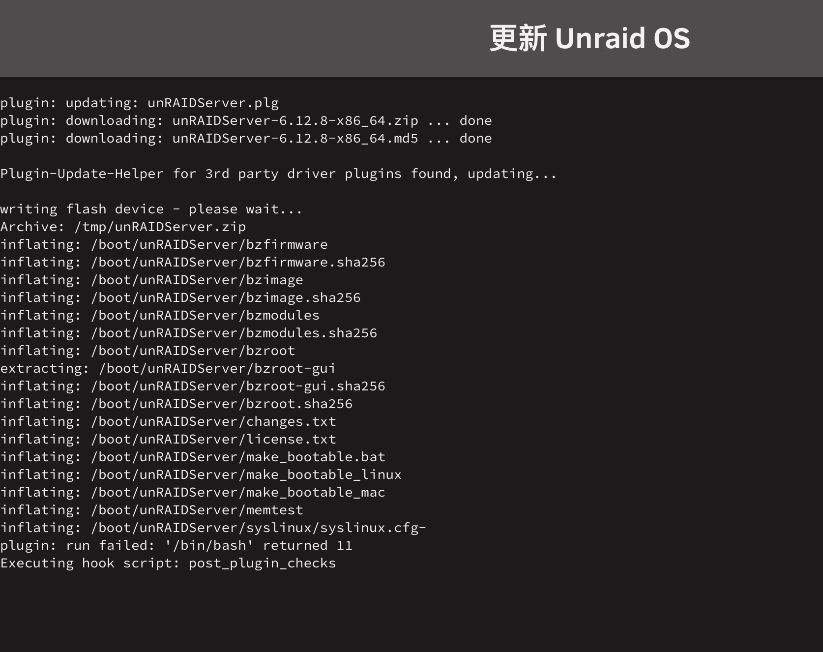

UPDATE 6.12.6 -> 6.12.8 FAILED
Solved by JorgeB
There are segfaults and multiple call traces, v6.12.6 is still working? Would also be good to see the complete diags.
V 6.12.6 has been running normally all along.
You can try updating again, then boot in safe mode and enable the syslog server, if it crashes again post that and fresh diagnostics.
The issue persists.
Try the manual update, download the zip and overwrite all bz* files and changes.txt, then reboot.
