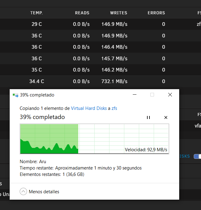

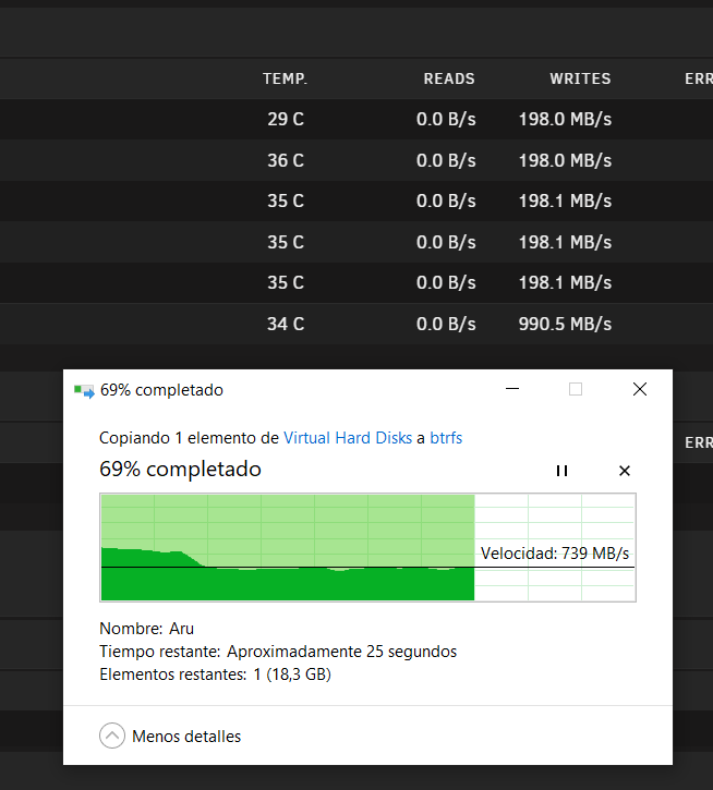

random ZFS performance in raidZ but peak in btrfs raid 5
i need any advice on how the f*** my machine can run *full speed* (or close enough)  with btrfs raid 5 but with zfs the speed is up and down every 3 seconds :S
drives are mixed ,but all of them work flawless in btrfs ,and not in zfs ,i have no explanation :/
Also i checked bottlenecks and i see none  ,this motheboard is a erying i5 12500h with turbo off (turbo on is the same) 32 gb ddr4 3200 hyper X beast ,and for the drives i use a nvme to sata converter ,yeah is not the best option but the only pci express x16/x8 is for the intel x520-1 card. Drives are al 4*8tb HGST shucked except 1 toshiba nas 8tb drive
also is not a pci express bottleneck and is not the nvme to sata converter. im open to suggestions ,until its fixed i will remain in btrfs raid 5 i guess . Also checked drives/controller with the diskspeed community tool and everything was perfect. iperf3 ruled out network problems ,and even if they were network related i guess btrfs would also have problems ?
ill attach some screenshoots of a 60gb file copy so everyone can understand better.
with and without jumbro frames the speed is the same ,so...

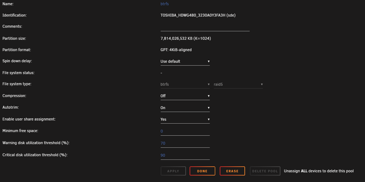

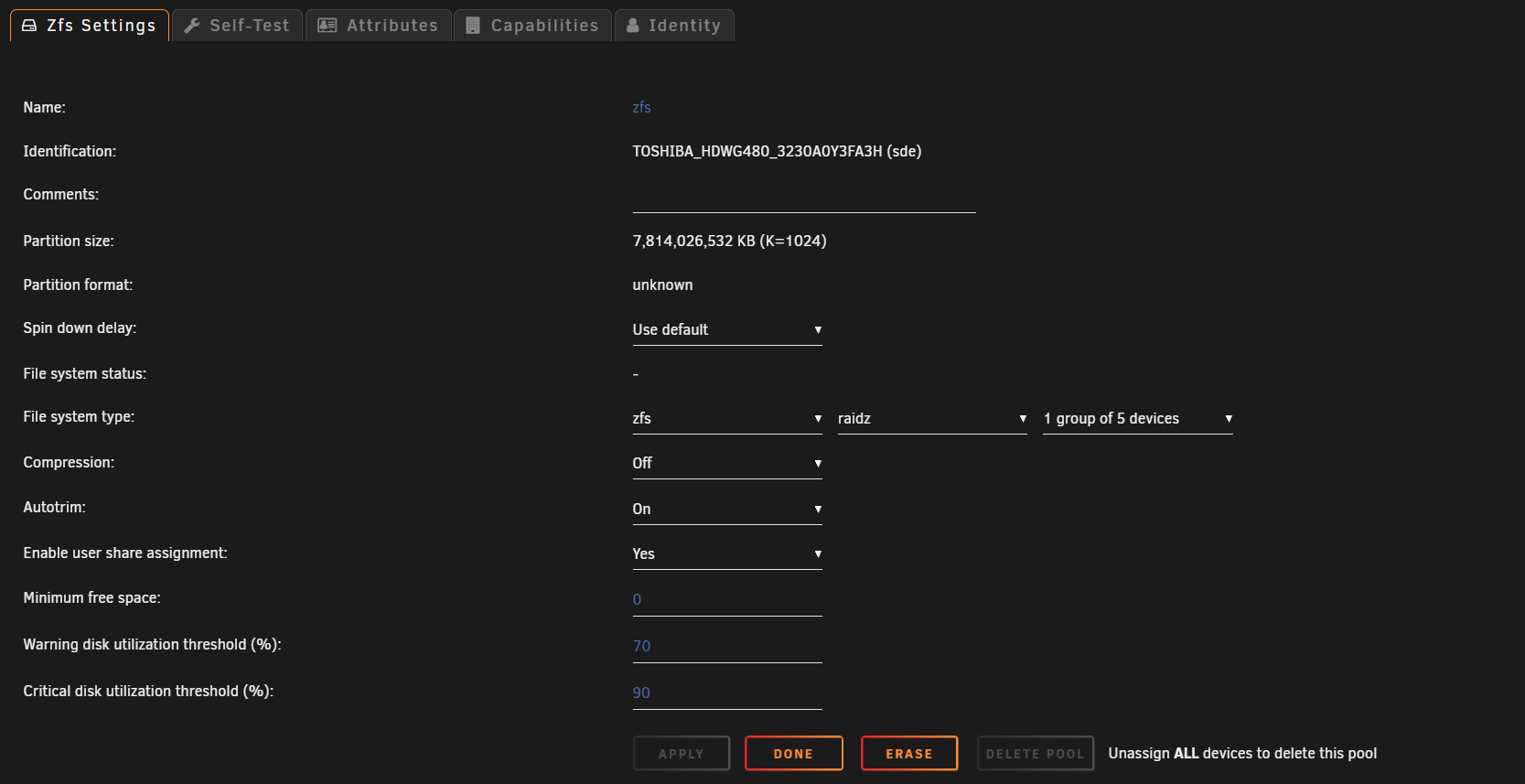

Can't really explain what you see, possibly zfs doesn't like one or more hard drives, can you try with 1M recordize? Performance should improve a least a little:
zfs set recordsize=1M pool_name
It will only affect new writes.
will try ,but im speechless ,i also tried other nas os included xpenology and they all perform better and even truenas that uses zfs the copy curve is stable
no up and down every 3 seconds :S
