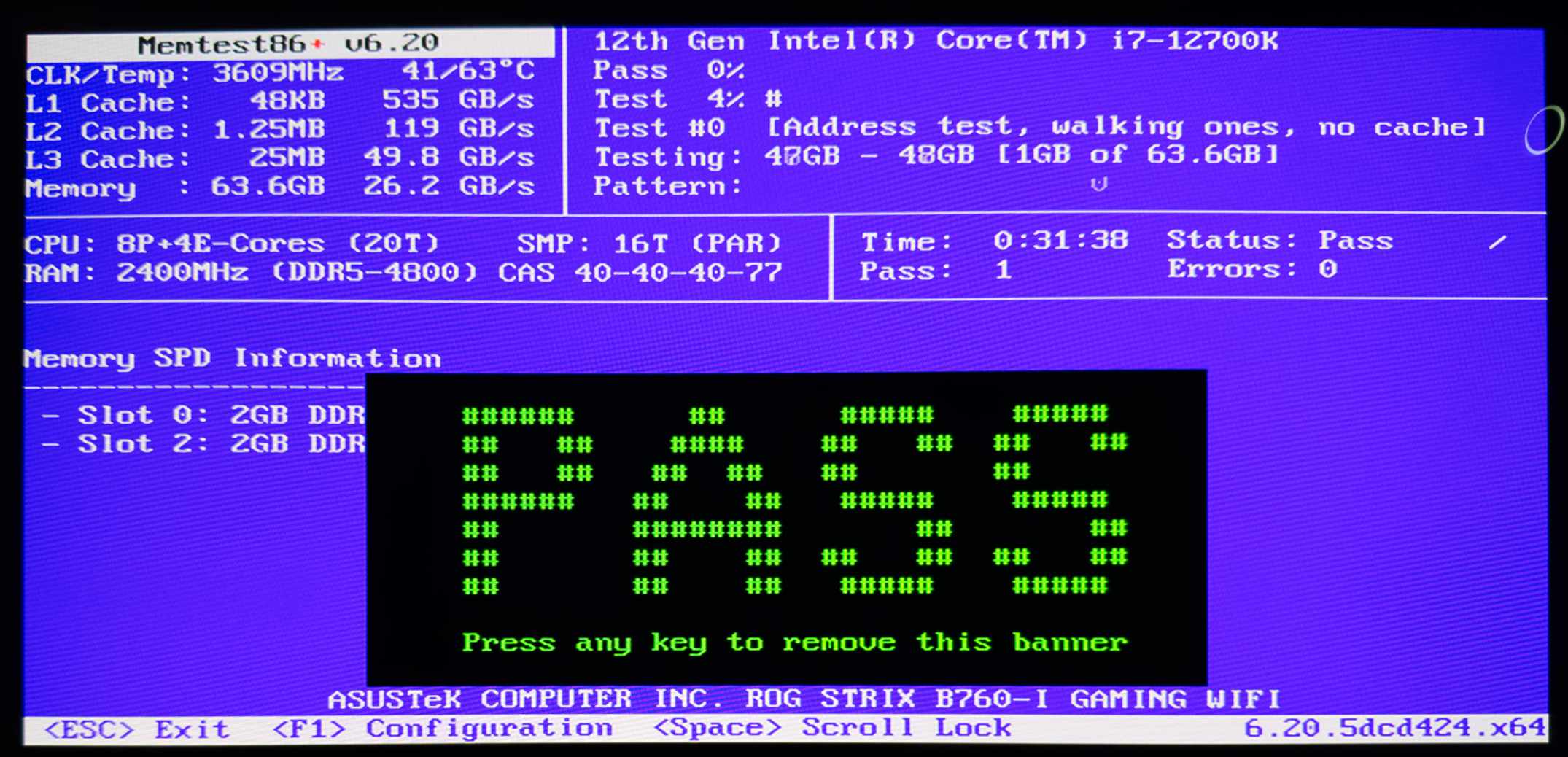

No issues reported by MemTest86:
Thoughts?

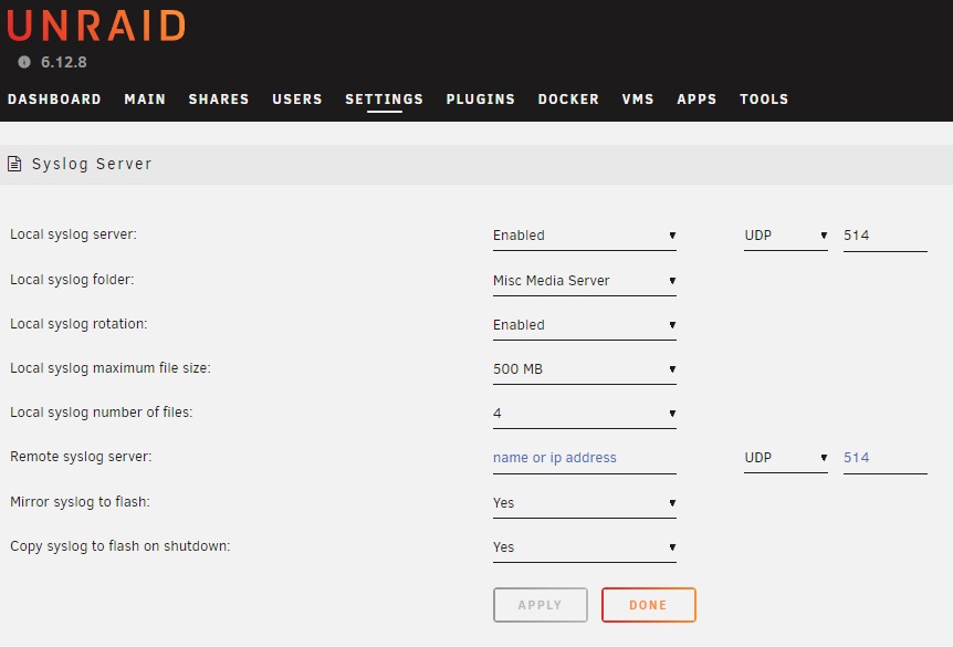

Enable the syslog server and post that after a crash, also try booting in safe mode and/or closing any browser windows open to the GUI, only open when you need to use it then close again.
Enabled Syslog server and will report back when this issue happens again:
