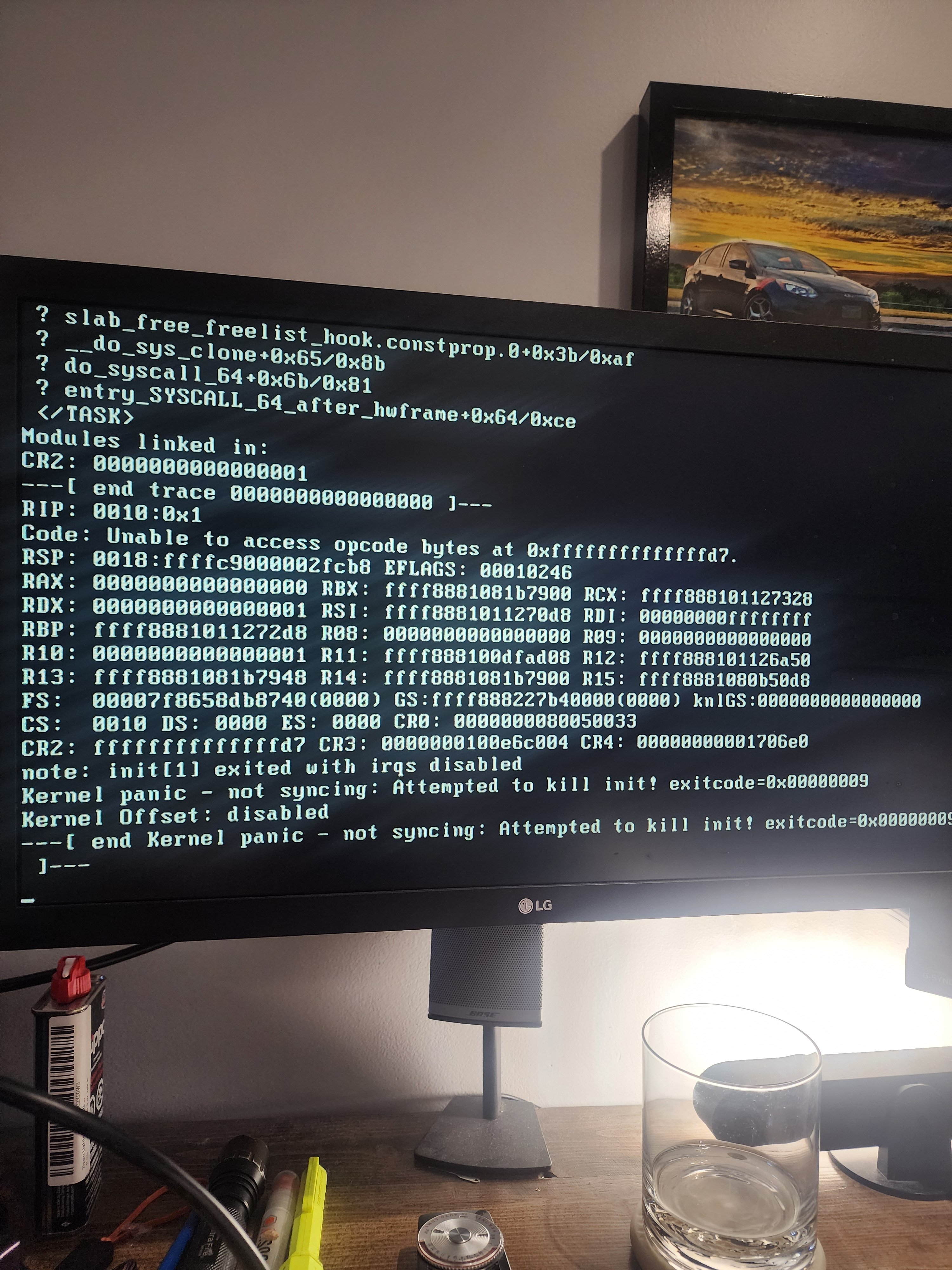

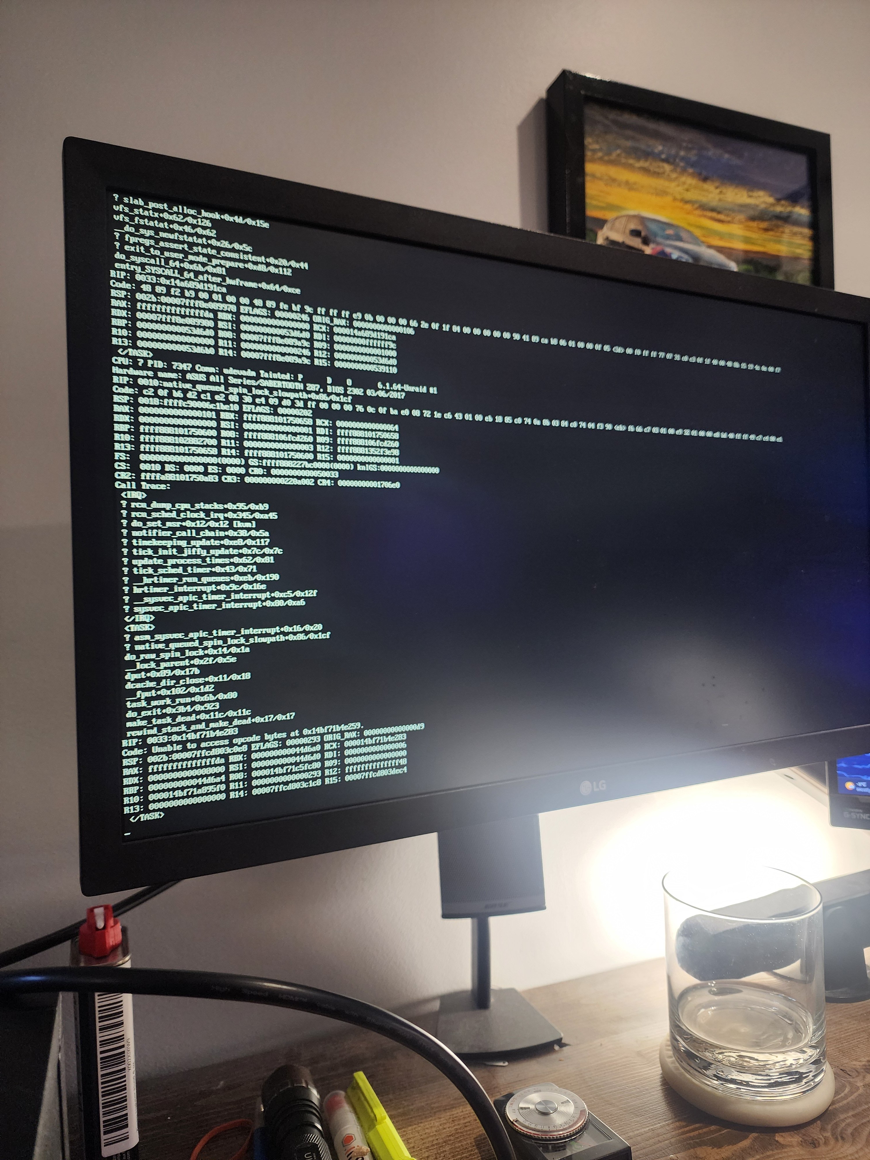

Unraid won't boot after swapping from i7 3770 to 4770k, as well as swapping motherboard. Keep getting "end kernal panic - not syncing : attempted to kill init! Exit code 0x00000009 any help greatly appreciated

I got ever so slightly closer by moving the usb to a different port. And starting in safemode. Logged in though web GUI, then stopped responding.
Try using a different flash drive with a stock install, no key needed, just to see if the issue is config related.
Yes, the new flash had the same issue. On a reboot the system failed to POST on a ram issue. Swapped ram with known working ram and all is well. Although I thought this ram was good, this is a silly lesson to learn. Don't assume hardware is working properly just because it was working at what time. Thankyou georgeb for your time.
