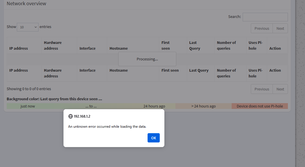

February 21, 20251 yr When I go to Settings - Network, I get "an unknown error occurred" Everything else is working as it should

February 28, 20251 yr Yeah, I can't complain that it doesn't work. The Settings - Network area being broken is the only real annoyance.
