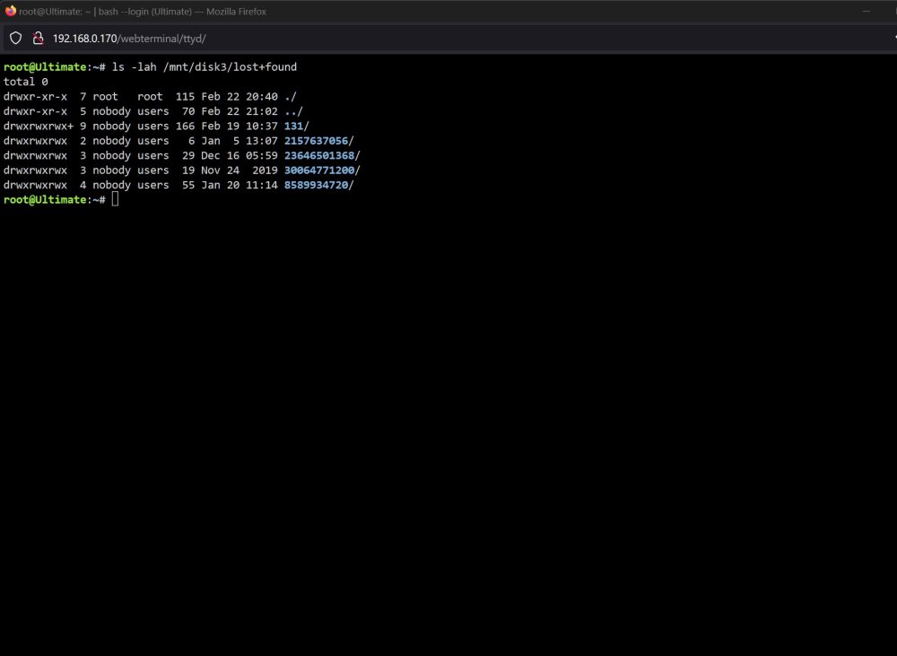

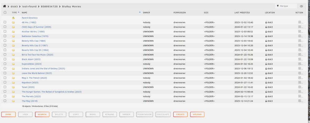

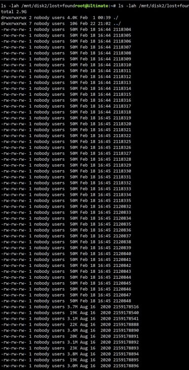

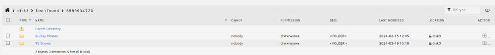

Do you have a lost+found share now?

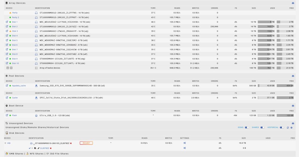

Actually I do, as well as some other very strange things. It looks like it's doing a parity check but 1 parity drive is not doing any reads or writes and I have 2 other drives not  doing any r/w. I also have 1 drive that says it's mounted in one place but unmounted in another place. I really don't know what to do at this point. I checked yesterday and all of the data seemed to be there, but today I'm missing lots of data!

Well, just looking at the drives now, I can't find the lost & found but it was there at one point, and the non rw drives show invalid path when I try to look at them. Not sure what happened, everything seemed ok yesterday!

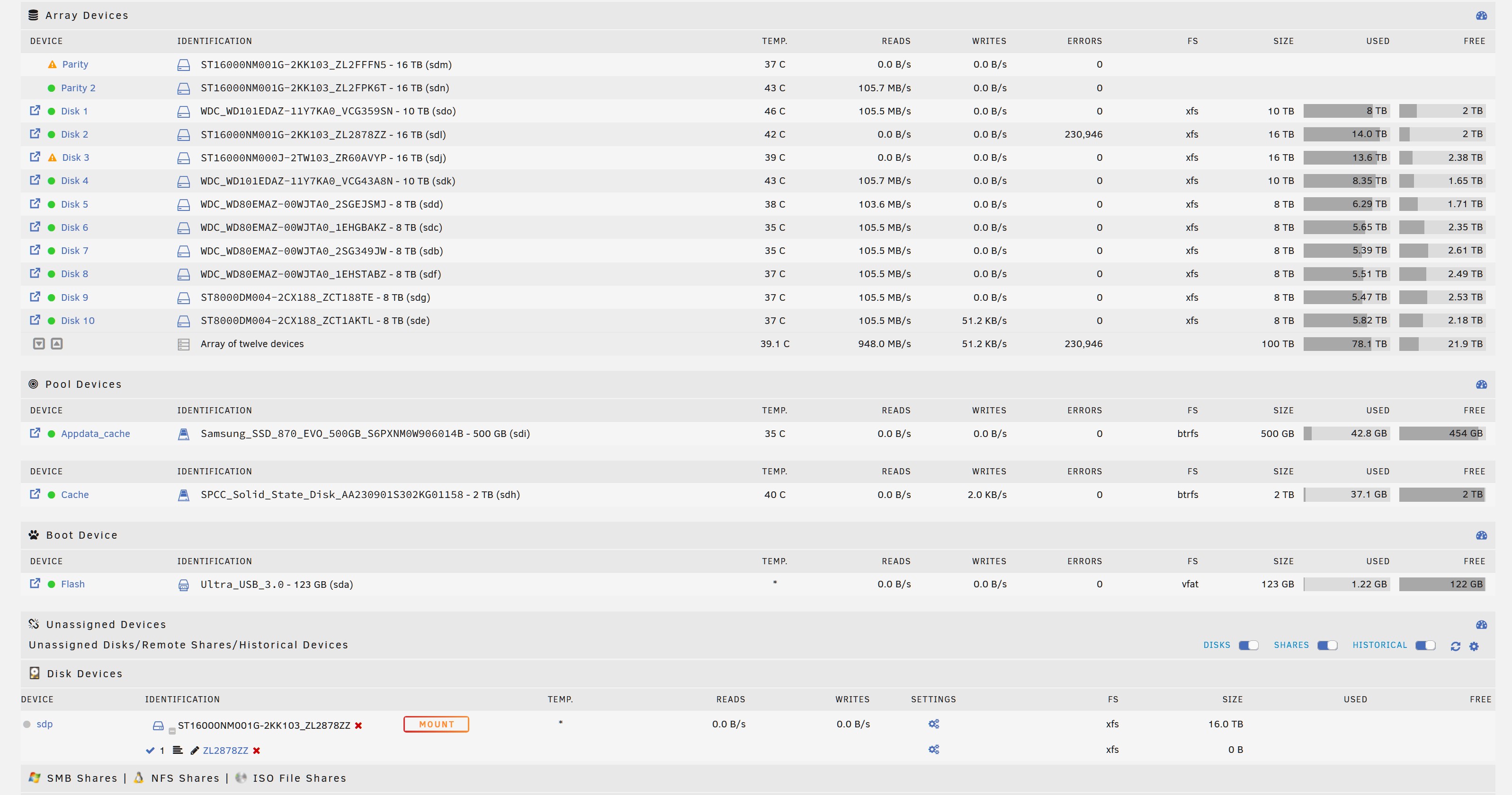

Your screenshot has clipped Array Operation section off the bottom so can't see what it thinks it's doing now.
It wasn't doing a parity check. It was rebuilding parity and disk3. But connection problems on multiple disks may have aborted that by now. Disk2 disconnected and became an Unassigned Device. It filled your syslog so can't tell what's happening now, but lack of activity also would indicate abort.
All array data disks mounted including emulated disk3, and with plenty of data. Not much data on either pool but maybe that is expected.
Nothing in lost+found
You will have to shutdown, fix whatever is causing these problems, reboot, and post new diagnostics.
How are these powered? Any splitters? Too many on one PSU cable?

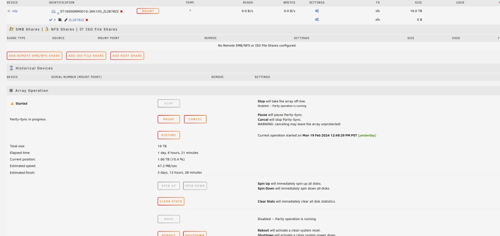

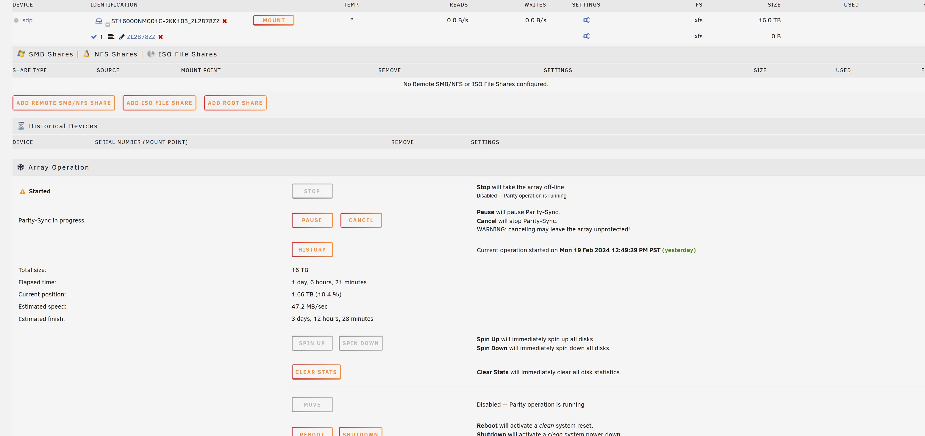

Ok, I just tried to cancel the parity check but it doesn't seem to be doing anything. Here is the part you couldn't see in the clip.
I just put in a Broadcom SAS 9300-8I 8-Port 12Gb/S SATA+SAS Pci-Express 3.0 Low Profile Host Bus controller and moved all of the 16tb drives and a couple of cache drives onto the controller. I was having lots of disk errors before putting in the broadcom, I think I changed the sata cables on all the drives prior to putting in the broadcom card at least 10 times and the errors continued, after I put in the new card all be it a day ago, I stopped getting drive errors. Any suggestions as to what I should do to try and fix the current problem?

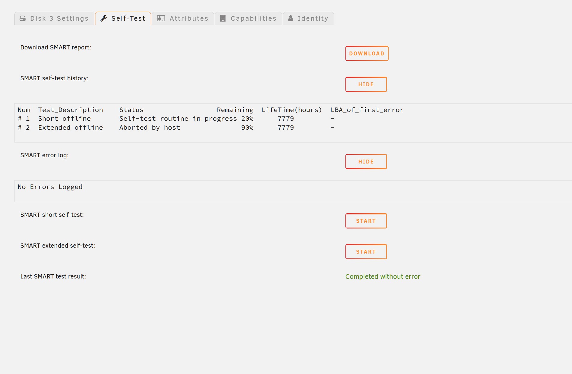

Just a quick update, I ran a short self test on the drives that were giving me read errors and the all passed, I was going to run the long test but it would take about 30 hours. I have also been running spinrite on parity drive 1 and it is almost complete and found no errors, so I don't know why I was getting the read errors. The sata cables off of the broadcom card are brand new and had no issues in the beginning. I can connect the drives back to the motherboard but I was getting lots of random errors. Should I use the flash backup on the flash drive? I have never done that before, is it just a matter of extracting it to the flash drive? I plan on running disk 2 on spinrite level 2 to check for errors but it will take 21 hours to complete. If you aren't familiar with spinrite, check it out at grc.com if you want, it's an incredible piece of software.
Ok, I have 2 drives out of the system right now, running the disk scan on them, so this diag dump will be missing those disks.
