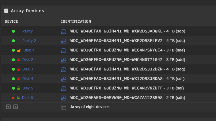

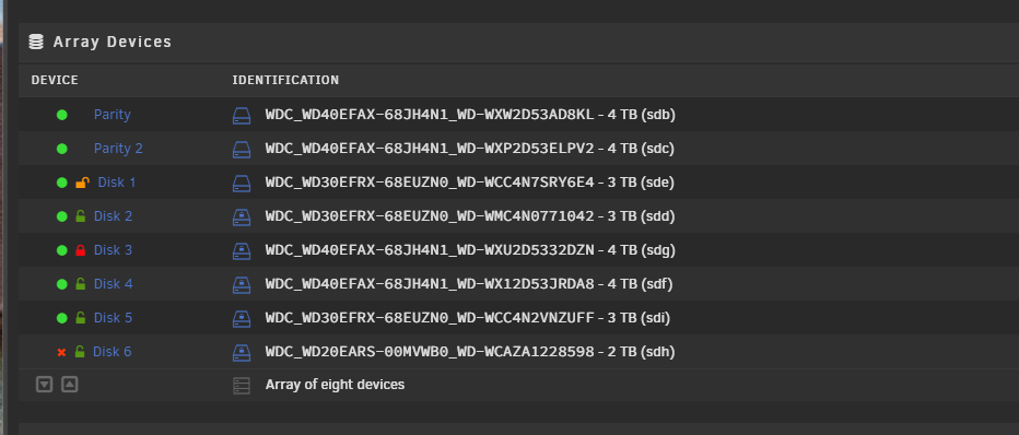

I have an issue with my unraid server not unlocking all my encrypted disks. I know the key is correct. The key has not changed since the arrary was created and i've seen disks successfully unlocked on one boot then locked on the next. So far i've tried disabling docker, disabling Virtual machines and removing plugins.
Even went as far as to boot in safe mode with no plugins loaded and got the same result. I'm at my wits end here and am thinking i may be looking at loosing close to 20TB of data because i mad the stupid design to enable encryption.
Below is an example of what i'm seeing

Looks like it might have been a bios setting. Set to factory and was able to open all disks.
Can also be RAM related, if you see it again recommend running memtest, also make sure the RAM is not overclocked.
