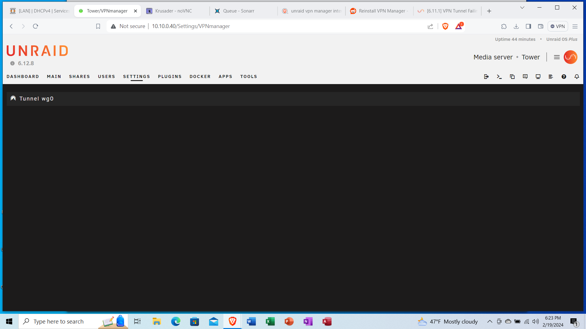

Hello everyone,
This is my first post here. I will admit that my knowledge level is just enough to be dangerous. I seem to have screwed up my VPN manager interface (as you can tell by the attached picture. I tried to follow a guide on youtube to create a wireguard tunnel to send all of mt torrent traffic through (because the vpn versions of qbit and deluge wont work for some reason) but I could not get it to work. I somehow ended up duplication a bunch of configurations, and then i found away to delete them, but now nothing shows up. I have no idea what to look for in the log window. This happened some time ago and I have been searching online trying to find out how to fix it but have come up empty. I have no idea how to access logs from weeks ago. I would appreciate if someone can at least point me in the right direction.
Thanks

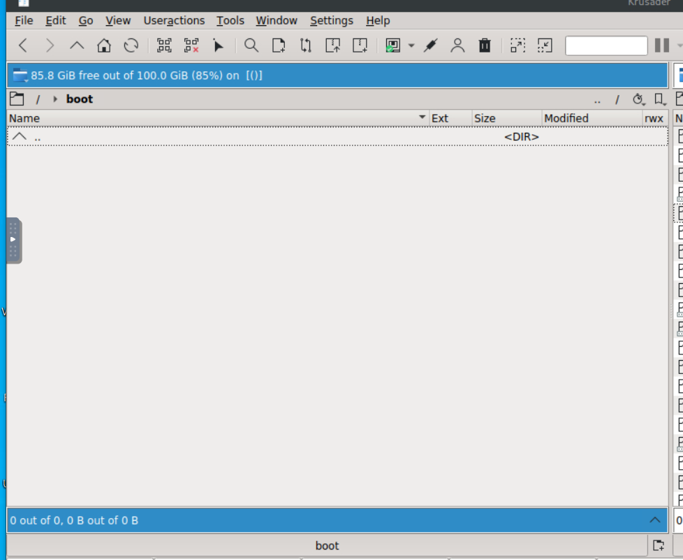

Try renaming any wg*.cfg files on /boot/config/wireguard to .bak, a reboot may then be needed.
It looks like my boot folder is empty for some reason.....
Probably because it's not mapped to your krusader container. Use mc at the console.

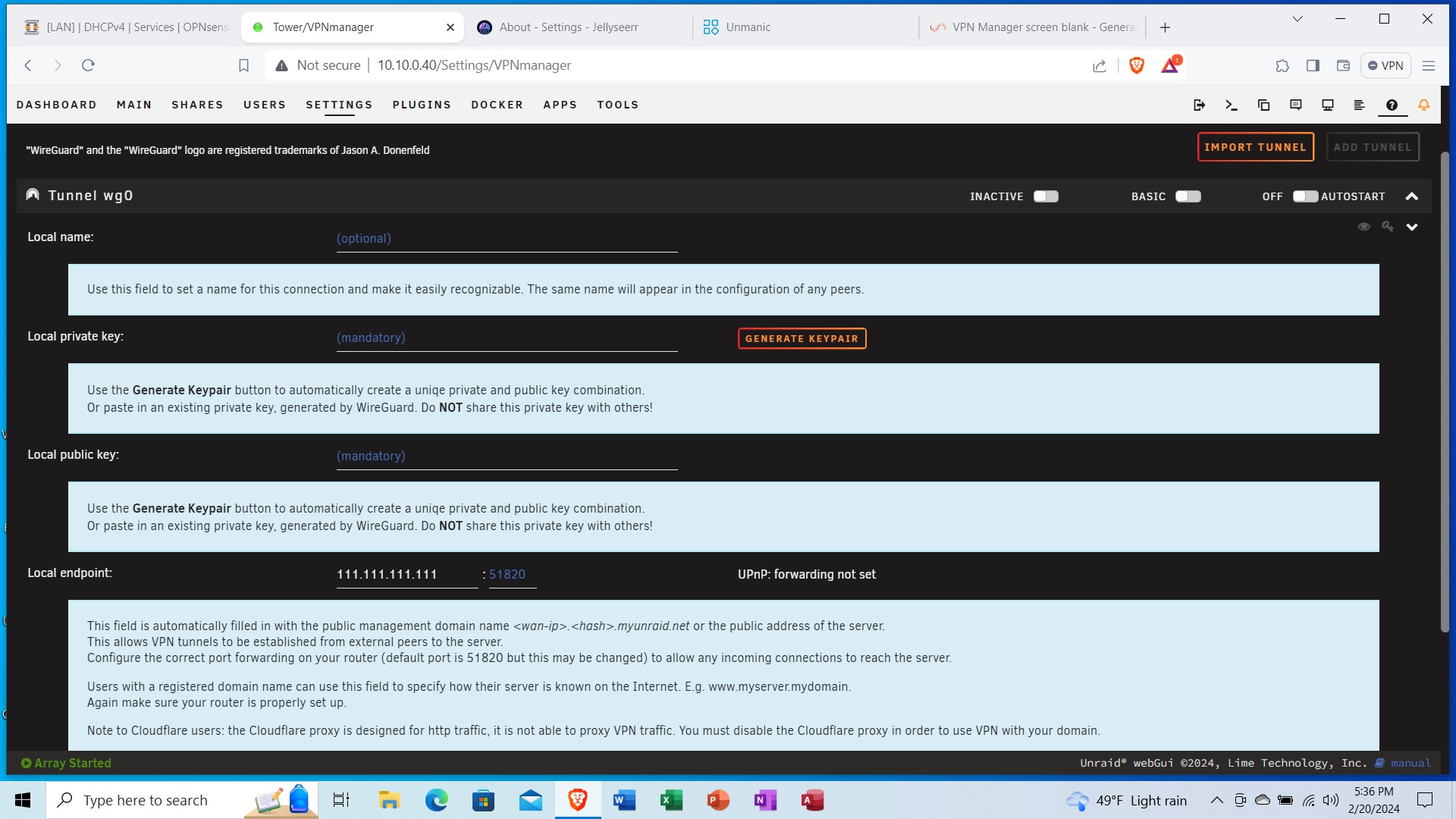

JonathanM  and JorgeB. Thank you so much! My vpn interface is now back up. I will try to find the guide to configure it again.
