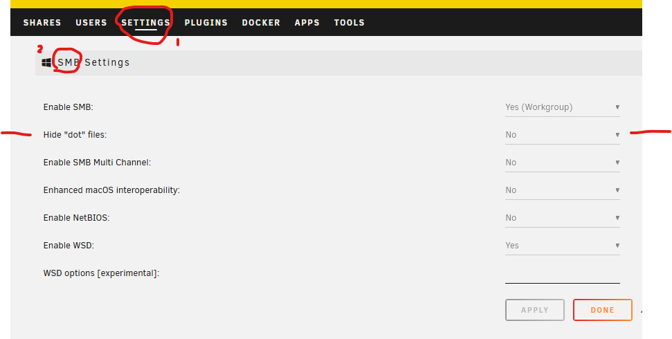

After updating my test server, the 'Hide "dot" files:' parameter in settings > SMB settings remained set to "no".
I could not find a 'Show "dot" files:' parameter however.
Edited by Opawesome
1 hour ago, Opawesome said:
I could not find a 'Show "dot" files:' parameter.
Step two is the "SMB"  under 'Network Settings'....
