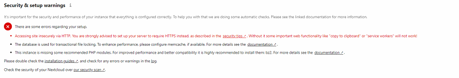

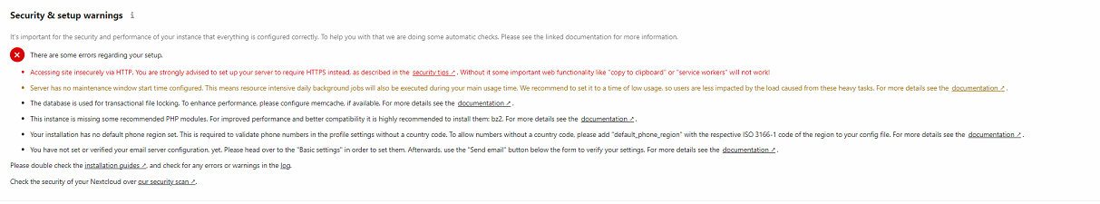

February 24, 20242 yr Author So I have cleaned up my Unraid server, removing all appdata etc from previous installs of nextcloud, Mariadb and nginx PM. I have now re installed Nginx, Mariadb, and nextcloud-ffmpeg. fresh install gives below errors/warnings. I can easily fix the below: 1. Maint Window 2. Default Phone Region 3. Email Server Config EDIT: below errors/warnings, I am work so i havent looked into these in detail yet. Edited February 24, 20242 yr by Daver1
February 24, 20242 yr First point is about fact that you do not have ssl certificate on site. Take a look maybe here 2nd point is to add redis database. Take a look about 3rd point I spotted it as well yesterday. But I think it’s nothing to be worry about.

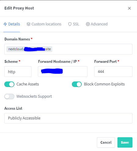

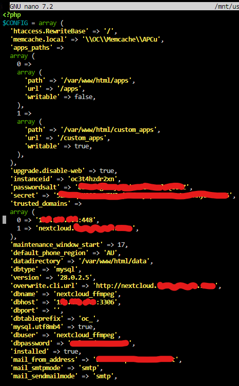

February 24, 20242 yr Author So i set up the reverse proxy as per video (assume this will rectify the ssl) and it then asked me to add the trusted domain to the config file. I have added that to the best of my knowledge and now i have the redirected too many time issue... I should note that my reverse proxy works with Overseerr. I have also tried with my DNS in both "DNS only" and "Proxied" configurations. This is where i gave up last time to be honest.. I can still access NC locally. Edited February 24, 20242 yr by Daver1

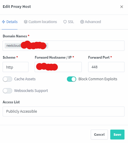

February 25, 20242 yr Author I have just re installed everything again and im pretty sure i have it set up correctly but i am receiving 502 bad gateway error.... i wonder if some old data from previous installs is causing this!
February 25, 20242 yr If You want to wipe out all configs for docker, after removing docker container, just delete appdata/<name of your container> folder and reinstall container. Are you setting it with SSL certificate or not? out of configuration it look like you are setting it without. I am not sure why you might have such issue. Anyway many peoples are using nextcloud without SSL and just by typing IP address and port. Maybe it will suits you?

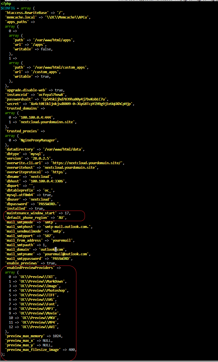

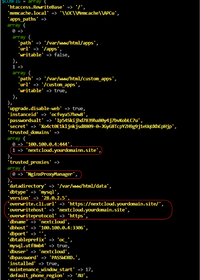

February 28, 20242 yr Author OK, so i started a fresh install using advice from this forum.. 1. Installed Nginx proxy manager 2. created a domain "nextcloud.mydomain.site" 3. installed docker container Mariadb (linuxserver container) 4. installed nextcloud-ffmpeg I have fixed various warnings that i received on initial start up. If any one else who is as uneducated as me wishes to hear how i did so please ask i will tell my steps.
February 28, 20242 yr On 2/22/2024 at 6:01 AM, Daver1 said: hopefully other can use this post also. 3 hours ago, Daver1 said: If any one else who is as uneducated as me wishes to hear how i did so please ask i will tell my steps. Perhaps you should follow through?

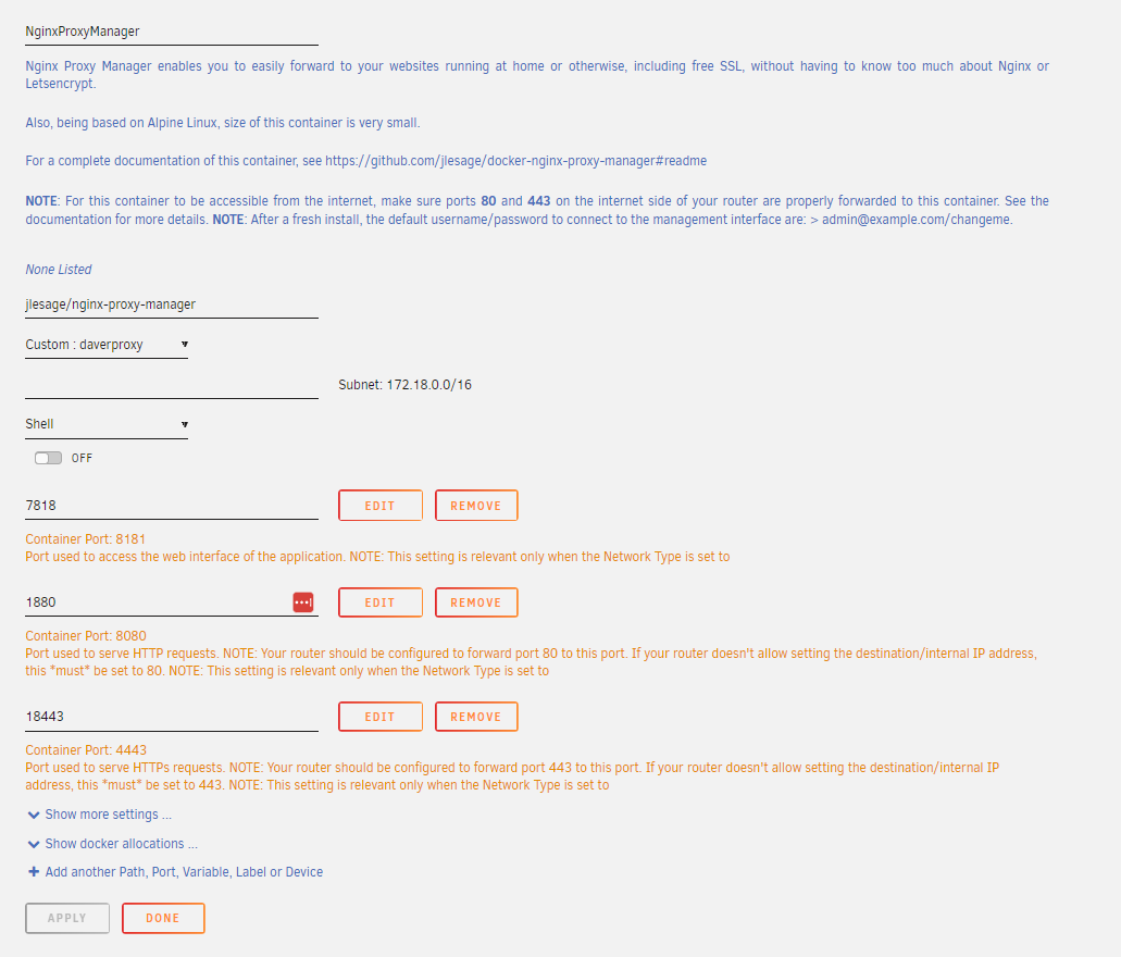

February 29, 20242 yr Author My guide - by a beginner for a beginner. I am starting without any knowledge of how the Linux system works - for 12 months i have blindly tried to make things work and only now really started to learn what it is a am actually doing.... You will see, I have quoted many resourses, the videos are critical to help gain an understanding of what you are doing (as a begginer) This is what i did and although it may not be perfect I hope its easy for someone like me to follow. 1. You will need a subdomain, i followed this video by spaceinvaderone. I created mine 12 months ago... You will want a subdomain such as "nextcloud.yoursubdomain.site" 2. I am using Nginx Proxy Manger. - this is from the app tab - jlesage template 3. For this guide, I followed along with the below Spaceinvaderone guide. I didnt install SWAG as I am already using NGINX Proxy Manager. PLEASE READ THROUGH WHAT I HAVE BELOW BEFORE WATCHING THE VIDEO AND THEN USE THE VIDEO AS A GUIDE AND REFER TO MY NOTES AS THERE ARE DIFFERENCES. IMPORTANT, Take your time, make sure the containers have fully installed and setup before moving on. Im not certain, but have a feeling that some on my initial problems came from rushing and moving on while Nextcloud was still installing. 4. Mariadb - Installed exactly as per video. 5. for my share, i personally used all disks (in the video he only uses disk 3) 6. For nextcloud i chose the Nextcloud-ffmpeg. 7. WAIT FOR NEXTCLOUD TO FINISH INSTALLING. YOU WILL SEE IN THE VIDEO THAT WE CAN GO INTO NEXTCLOUD LOG AND SEE WHEN IT HAS FINISHED INSTALLING. 8. log in and set up nextcloud as per install video. 9. For the reverse proxy, you dont need to use SWAG (Swag was way easy to make a mistake and then for later use - complicated) For setting up NGINX i have followed the below guide. Note: You will need to port forward in your home router setup. https: "external/outside/from" port 443 -- forwarded to -- (in my case) "internal/inside/to" port 18443 http: "external/outside/from" port 80 -- forwarded to -- (in my case) "internal/inside/to" port 1880 We set those ports (18443 and 1880) inside the nginx docker container. NGINX is super easy to use, I use the WEB UI to setup a reverse proxy. I have only made changes to the 2 below tabs as you can see. 10. To setup nextcloud-ffmpeg to work with NginxProxy Manager we need to edit the config file. In Unraid, i opened terminal and tped the below: nano /mnt/user/appdata/nextcloud-ffmpeg/config/config.php see my below config as example. (this is in the video guide but a different trusted Proxy is different) note - your config may look different to this as you will have different domain names and passworsetc. your config will also change when nextclopud sets itself up. 11. as per video set up custom proxy. hopefully you should be up and ruinning. Warnings/errors after install: No maint window = Add below to config.php: 'maintenance_window_start' => 17, the 17 in above is 5pm utc = 1am Perth Australia time. No Default Phone Region set = Add below to config.php: 'default_phone_region' => 'AU', Above is the Australian code - a quick google will tell you the correct code for your country. just google something like " nextcloud default phone regom country codes" If anyone ever uses this guide and finds issues and or additional warnings, ill try my best to help out.. mainly i just google it and if i can ork it out I come onto unraid forum and ask. Adding the fixes that i have added are highlighted in my config file below, i will also highlight where i have added the text to allow mp4 thumbnails. Note: dont add anything i havent highlighted as it will likely have been auto populated by nextcloud during the install. I havent changed anythinels that is not highlighted. in terminal again i enter: nano /mnt/user/appdata/nextcloud-ffmpeg/config/config.php Edited February 29, 20242 yr by Daver1

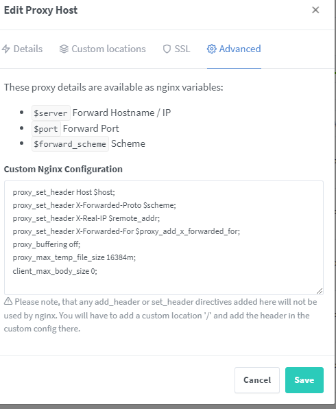

February 29, 20242 yr Add this to NGINX in the advanced tab/custom nginx configuration to allow for large file transfers in nextcloud proxy_set_header Host $host; proxy_set_header X-Forwarded-Proto $scheme; proxy_set_header X-Real-IP $remote_addr; proxy_set_header X-Forwarded-For $proxy_add_x_forwarded_for; proxy_buffering off; proxy_max_temp_file_size 16384m; client_max_body_size 0;
February 29, 20242 yr 6 hours ago, Daver1 said: I have done my best here as a complete noob, and tips or things you think i should add or change please let me know? Thank you for for your write up. If I see positive comments from others saying it was helpful, I'll probably move the whole thread back into the guides section instead of the lounge. If you want to start a clean thread there with just the steps and notes instead of moving this thread, let me know. As you now know, documentation is a weak point of Unraid, we appreciate anyone willing to take the time to do writeups that are helpful to others. The reason your post was initially moved OUT of the guides area was that it was NOT a guide at that point, it was a request for support, hoping to turn into a guide.
February 29, 20242 yr Author 20 minutes ago, Michael_P said: Add this to NGINX in the advanced tab/custom nginx configuration to allow for large file transfers in nextcloud proxy_set_header Host $host; proxy_set_header X-Forwarded-Proto $scheme; proxy_set_header X-Real-IP $remote_addr; proxy_set_header X-Forwarded-For $proxy_add_x_forwarded_for; proxy_buffering off; proxy_max_temp_file_size 16384m; client_max_body_size 0; I like this! not sure how to add it and those who my post are aimed at may not either.. I've just started to use dynamix file manager maybe using this? any further tips on this?
February 29, 20242 yr Author 20 minutes ago, JonathanM said: Thank you for for your write up. If I see positive comments from others saying it was helpful, I'll probably move the whole thread back into the guides section instead of the lounge. If you want to start a clean thread there with just the steps and notes instead of moving this thread, let me know. As you now know, documentation is a weak point of Unraid, we appreciate anyone willing to take the time to do writeups that are helpful to others. The reason your post was initially moved OUT of the guides area was that it was NOT a guide at that point, it was a request for support, hoping to turn into a guide. I had not even thought to add it to the guides section..... As you say lets see if a) anyone is trying to set this up, not already at a level much higher than me (thus my guide is irrlavant) or b) it has positive coments. Thank you.
February 29, 20242 yr 6 minutes ago, Daver1 said: I like this! not sure how to add it and those who my post are aimed at may not either.. In the advanced tab/custom nginx configuration..
February 29, 20242 yr Author eternally better than trying to update the nextcould config (thats how i thought it was done) Edited March 19, 20242 yr by Daver1

July 19, 20242 yr On 7/16/2024 at 5:06 AM, Daver1 said: did you figure it out? *EDIT4* I got it working. Only problem I'm having is with cloudflare saying my record A IP is exposed. Is there a way around this? Without setting cname to dns only nextclould wont work. *EDIT3* I changed the scheme to https in nginx and now I'm able to access nextcloud locally. Outside of my network though I get too many redirect error in safari and firefox. I have not been able to figure it out. When nextcloud didn't have a host name it was accessible but once I did the edits to give it a hostname I was unable to connect to it directly or by clicking it in nginx. I really have no idea where the problem is. I don't know if it's related but I don't know what to put in the cloudflare cname content field. Nothing I watched/read ever addressed that and just showed them putting in information related to the video uploader. Here is what I can tell you. my proxy host is set to nextcloud.mysite.domain, destination is internalIP:444. nextcloud edited from "internalip" to nextcloud.mysite.domain. When I click webui in unraid the url address starts with the localip and then quickly flips to nextcloud.mysite.domain. Cloudflare has the cname dns added as name nextcloud and content mysite.dns <-- this is what I personally have no idea about. I tried setting it to mysite.domain but then it says it exposes the ip or something. I can turn on the proxy setting on cloudflare and that warning goes away but the settings in your guide show it set as dns only. Even set that way though I still get server not found. No matter what I do it just says server not found. I have the ports fowarded in my udmpro. I don't know if it matters but I do run a pihole. I haven't seen anything being blocked in it though. *EDIT* I didn't change anything and now it says "this page isn't redirecting properly". *EDIT2* Taking the proxy off on cloudflare so that it says my cname exposes ip of A has made it say 400 error plain http was sent to https port. Edited July 20, 20242 yr by Tenno23
