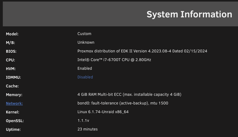

i installed an unRAID vm on ProxMox as a test.
How can i enabled IOMMU in unRAID?
I understand that in previous versions of ProxMox it was perhaps possible but now with version 8 it is no longer possible?
I know it doesn't make sense but I wanted to try switching a GPU to a nested Win11 VM as a test via unRAID
On ProxMox host is all OK.....i think.....
It's possible?

Not sure if this works.
qm set 100 --args '-device intel-iommu,intremap=on,caching-mode=on -machine accel=kvm,kernel-irqchip=split'
https://bugzilla.proxmox.com/show_bug.cgi?id=3784
I had seen it but this command works only at the VM level?
I mean.....if it doesn't work it won't ruin anything at the ProxMox host level right?

Correct is is just passing args into the qemu binary for the vm that is being started
It works, IOMMU is enabled in Unraid-VM inside Proxmox after this + Unraid reboot.

Yes, it works but.....I tried to passthrough my iGPU but it doesn't work..... Have you tried passthrough some hardware to see if it really works?
Yes, I can pass-through SATA-Controller (or disks), I also have a nVidia GPU passed through, works fine.
