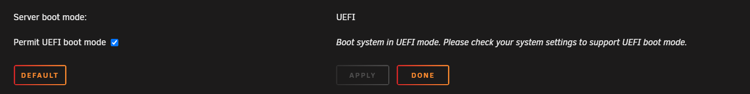

on unraid web ui, I've clicked on flash drive and at the bottom it shows this enabled

as i said i have done that previously before moving to unraid , with the screenshot i shared I'm wondering if Permit UEFI boot mode should be ticked
That just has the same effect as
3 hours ago, Atilla0406 said:
rename "EFI-" folder to "EFI"
thank you , i had thought this could be the problem
