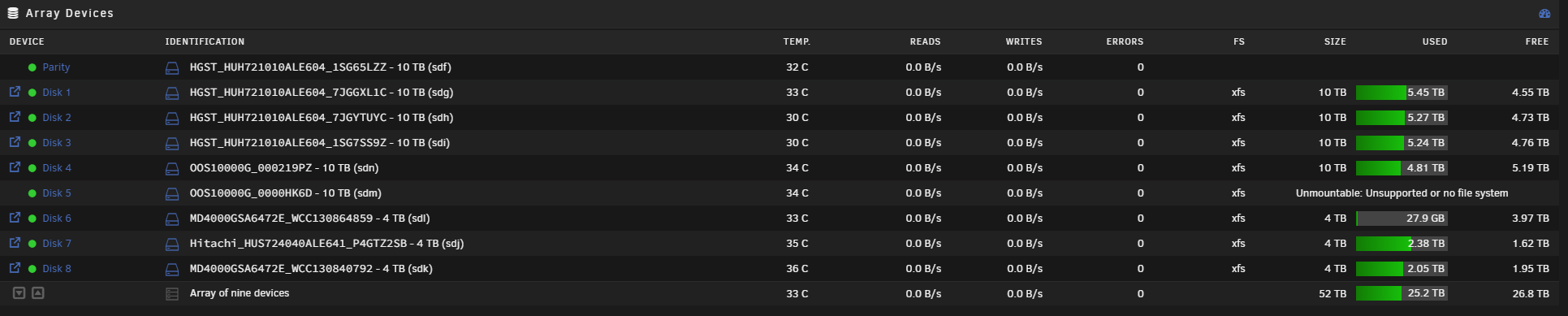

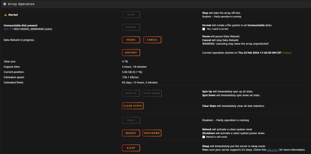

A few days ago, disk 6 failed in my array.  I had a spare on hand, replaced the drive, and let the system begin a rebuild.  The rebuild progress was running at a snails pace, between 500 and 800 KB/s.  it took over 2 days just to get to ~600G written, with an estimated finish over 70 days.  While I was looking for solutions, I noticed that 6.12.8 released, I was on 6.12.6, and figured I might as well cancel the rebuild and perform the upgrade in the hopes that it might speed things along (maybe a bad idea in hindsight?).  The upgrade completed without any errors and I was eventually prompted to reboot the server.  I enabled syslog logging to the USB drive before rebooting because I anticipated the need to upload diagnostics for the slow rebuild issue.  After the reboot, the server came back online with the array stopped.  I expected this because the replacement drive had not finished rebuilding.  I verified the correct drive was assigned to the failed slot and started the array.  When the array started, the data rebuild started up and I noticed that one of my other disks was now showing "Unmountable: Unsupported or no file system".  Is there any hope of getting that disk back online and mounted?  I'm a little nervous to begin troubleshooting that on my own, although I did stop the array and restart it to see if that might work.  Also, the data rebuild of the other disk is still crawling along at ~700 KB/sec with an ETF of 64 days.  Diagnostic file is attached.  I'm hoping this is recoverable and I can get the failed drive rebuilt.  At the moment, I still have VM's and Docker services stopped.  Thanks, in advance, for any assistance you can provide.  If you have questions, I'll do my best to have answers. Dashboard images below...

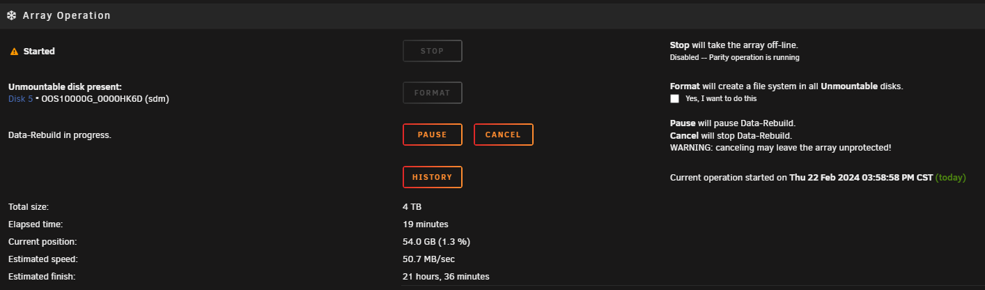

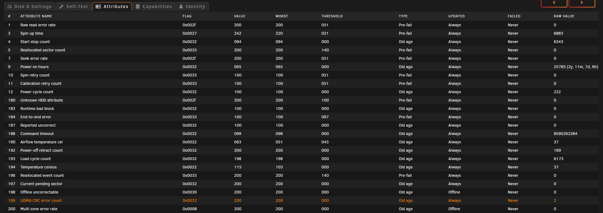

Disk 6 is back to original.  It was throwing UDMA CRC errors (2), so that's why I replaced it to begin with.  It is now rebuilding and doing so at a much faster pace.  50 MB/Sec and estimated finish is in 23 hours.  I'm still getting the "Unmounted: Unsupported or no file system" status on Disk 5 though.

UDMA CRC errors
These are connection problems, not disk problems.

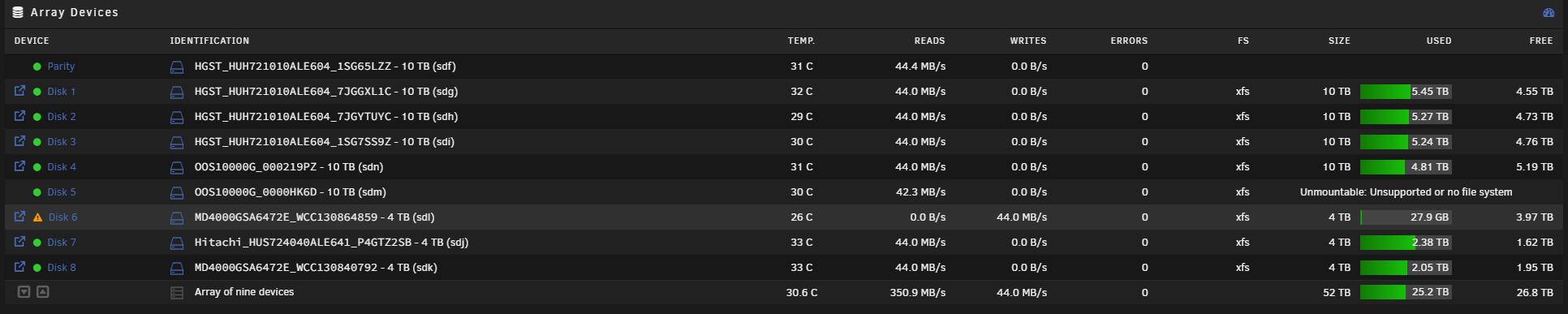

Also, the rebuild process seems to be reading from that disk 5.  Is that bad?  You can see the reads in the last image I posted.

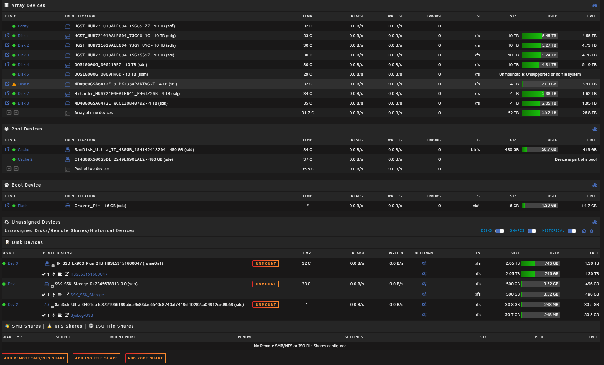

Disk 6 (the original one) has finished rebuilding, but it doesn't appear there is any data on it.  The size only shows 27.9GB used.  I did try stopping and restarting the array to see if it would update, but no go.  New diagnostic file attached.  I also thought about stopping the array and trying to mount disk 6 with unassigned devices just to check for data that way, but I didn't want to take that chance without checking in.  Suggestions for next steps?

There wasn't any on it in your first screenshot

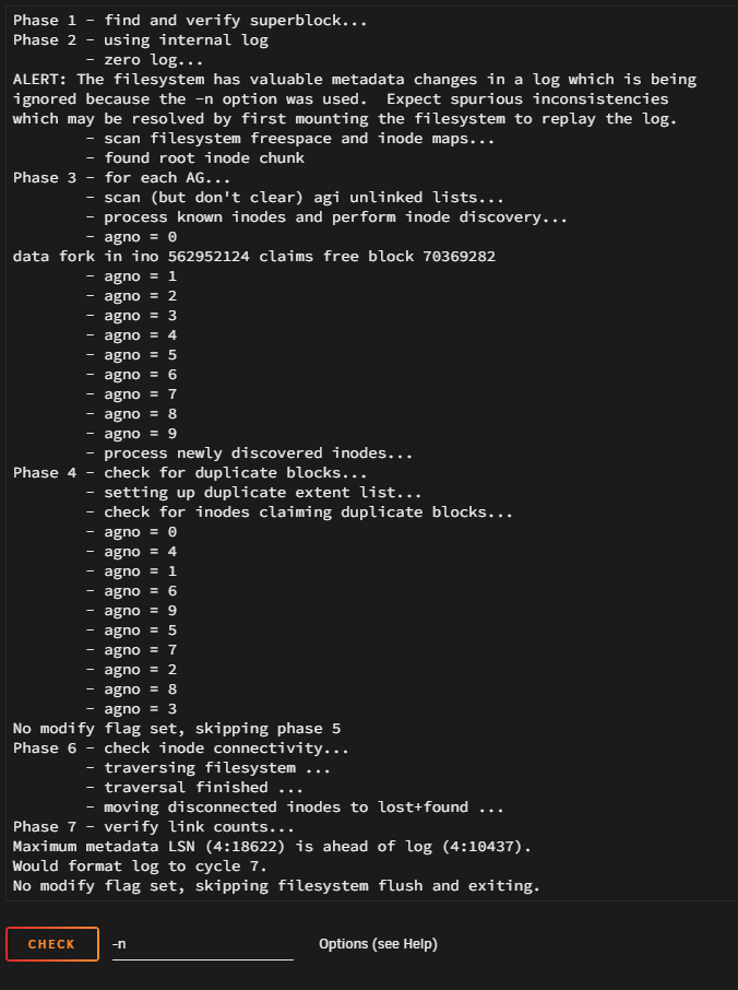

Check filesystem on disk5. Do it from the webUI to make sure it uses the correct command. Post the output.

I stopped the array, put in maintenance mode and did the check.  Haven't messed with cables yet.  Here is the output screenshot (I can post the actual text if you like, but the formatting was wonky):

Do it again without -n. If it asks for it, use -L. Post the output
Had to use -L

Start the array in normal (not maintenance) mode and post new diagnostics.
That looks good except for disk6 which you must have formatted
