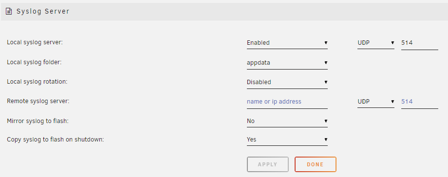

I woke up this morning to an unresponsive server, and had the syslog setup as below in this image,image.png.66999bba4b53ac9375094dc3e0360908.png
After the hard reboot and starting the array, i dont see any logs in my appdata folder.
Is there a step I am missing?
You need to set the server's IP on the remote syslog server field, or just enable the mirror to flash drive option.
