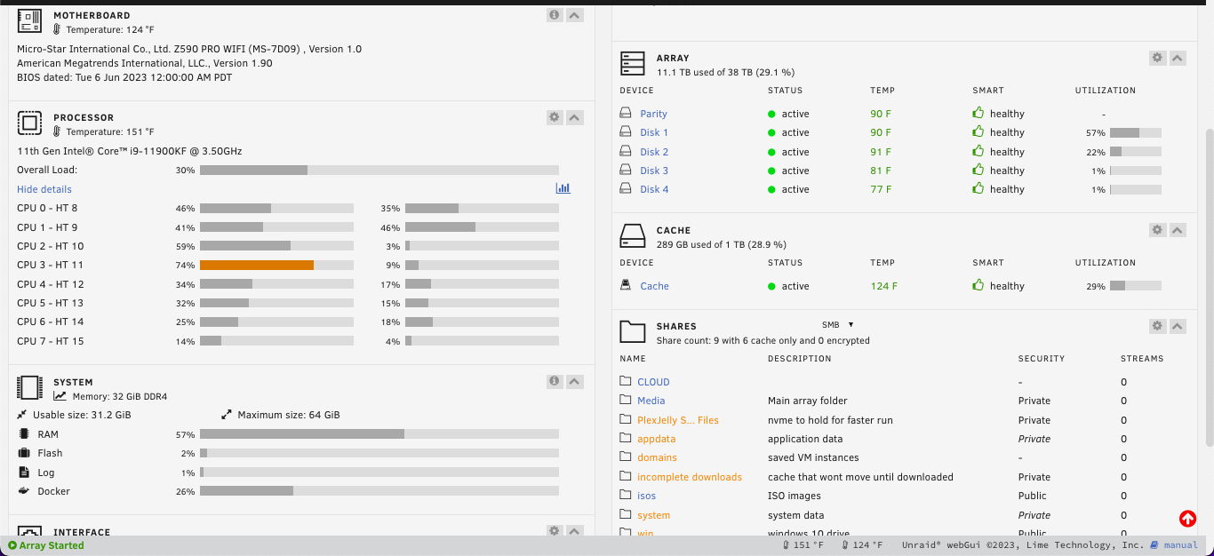

Hi everyone, I am a new unraid user and I thought I had everything installed smoothly but the last two days now I have had unexpected crashes.  I get no warning before this happens so I am not sure how to recreate it.  I did grab a screenshot of the dash that was frozen while the server restarted. I also attached the diagnostic zip grabbed after the reboot.
The only things I had running at the time of both crashes was qbittorrent and my windows vm.
