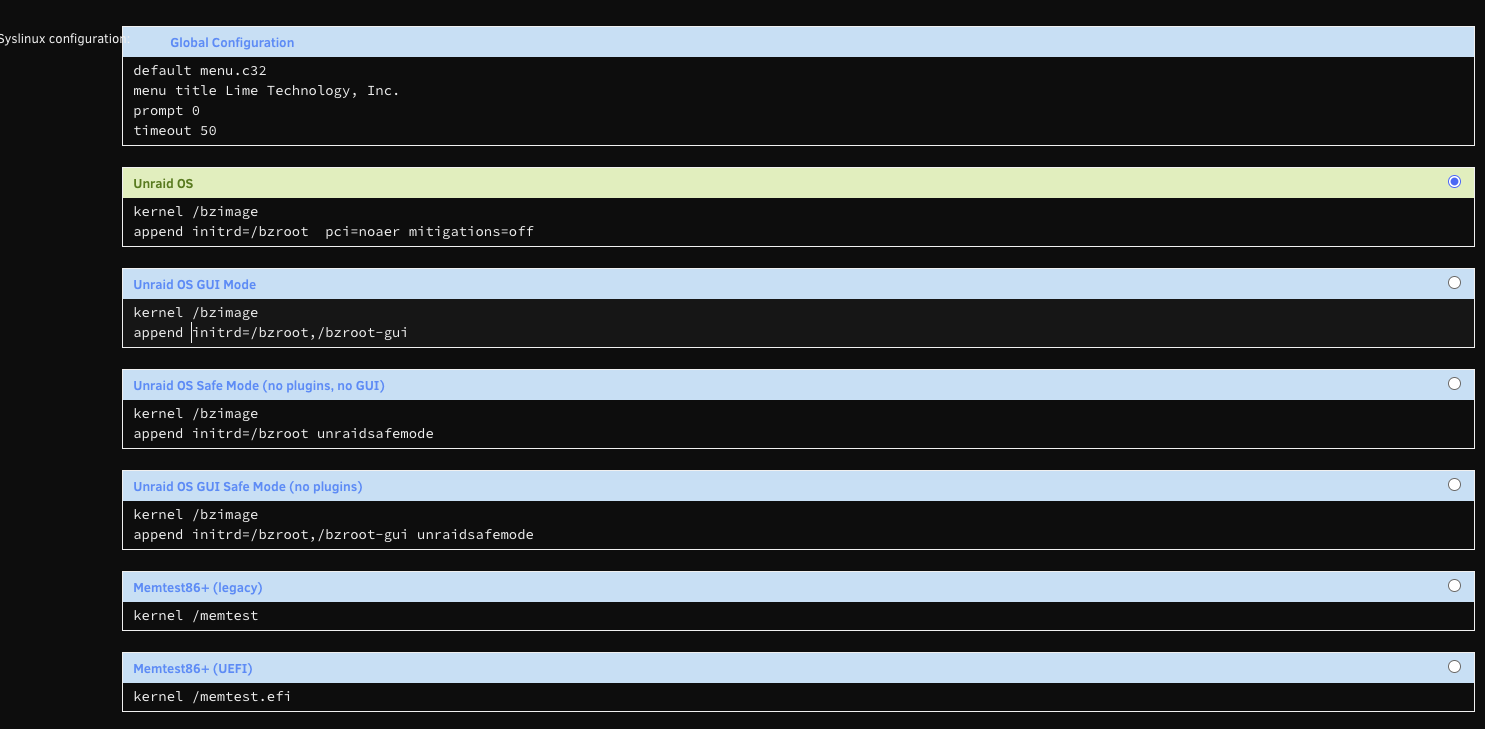

Solved by Squid
From Main, Go to Boot Device, then click on Flash followed by Syslinux Configuration
In the section that has the radio button selected (ie: your default boot mode), add in to the append section
pci=noaer
The section will wind up looking like this (assuming the default non-gui boot mode)
kernel /bzimage
append initrd=/bzroot  pci=noaer
Don't remove anything else that you may have added yourself (or was added in via another setting in the GUI - eg: the mitigations=off on mine).
You'll need to reboot for the changes to take effect after applying them
