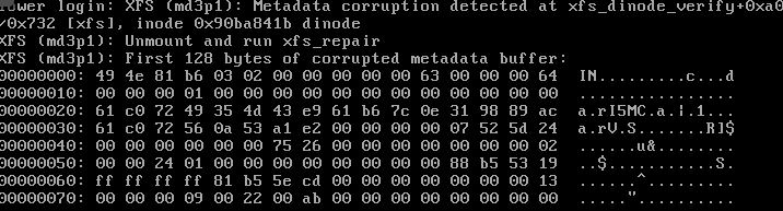

good morning, this morning I tried to log onto my unraid and discovered that none of the shares or server was responding, so I did a hard reboot, and this then allow the server to reboot back up.
I was then able to URL onto the server and start the array, but on the monitor that I have attached I see the following  ( please refer to attachment.
not having a good knowledge of Linux,   can someone please help me to resolve this issue ?
I did stop mu array, and run the command and then I got loss as it was asking me questions I didn't know how to answer.
The process is covered here in the online documentation accessible via the Manual link at the bottom of the Unraid GUI.  In addition every forum page has a DOCS link at the top and a Documentation link at the bottom.   The Unraid OS->Manual section covers most aspects of the current Unraid release.
