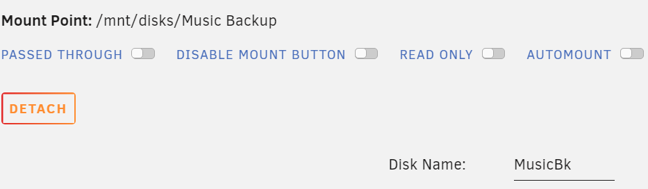

The 'diskname' is the alias you assign to the disk:
This is a user script I use to perform a backup to that disk.  It can be done on a schedule with User Scripts.

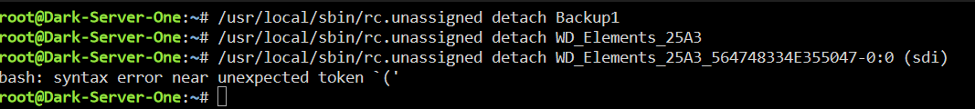

Okay, the i think the serial is the easiest one, because it was the first thing i found and makes sense.
But i still can't find the correct /dev/sdX or devX designation for my drive to detach it:
Edited by Darkestnoir
18 minutes ago, Darkestnoir said:
But i still can't find the correct /dev/sdX or devX designation for my drive:
You don't need it.  Use the alias you assign and then the device for all commands is 'name=alias'.  In the case of the detach command, 'name-alias' does work.  I see in the UD page it is not documented in the help that the alias can be used.  I'll correct that.
Edit: In your case use:
/usr/local/sbin/rc.unassigned detach name=Backup1
Okay, still not sure what do you mean, i tried all 3 possibility's i can think of, none worked here, see the picture above.
Ah ty, maybe also add this to the help thing:
'/usr/local/sbin/rc.unassigned detach name=diskname' - detach device by disk name.
Just did.  It will be in the next reelease of UD.
