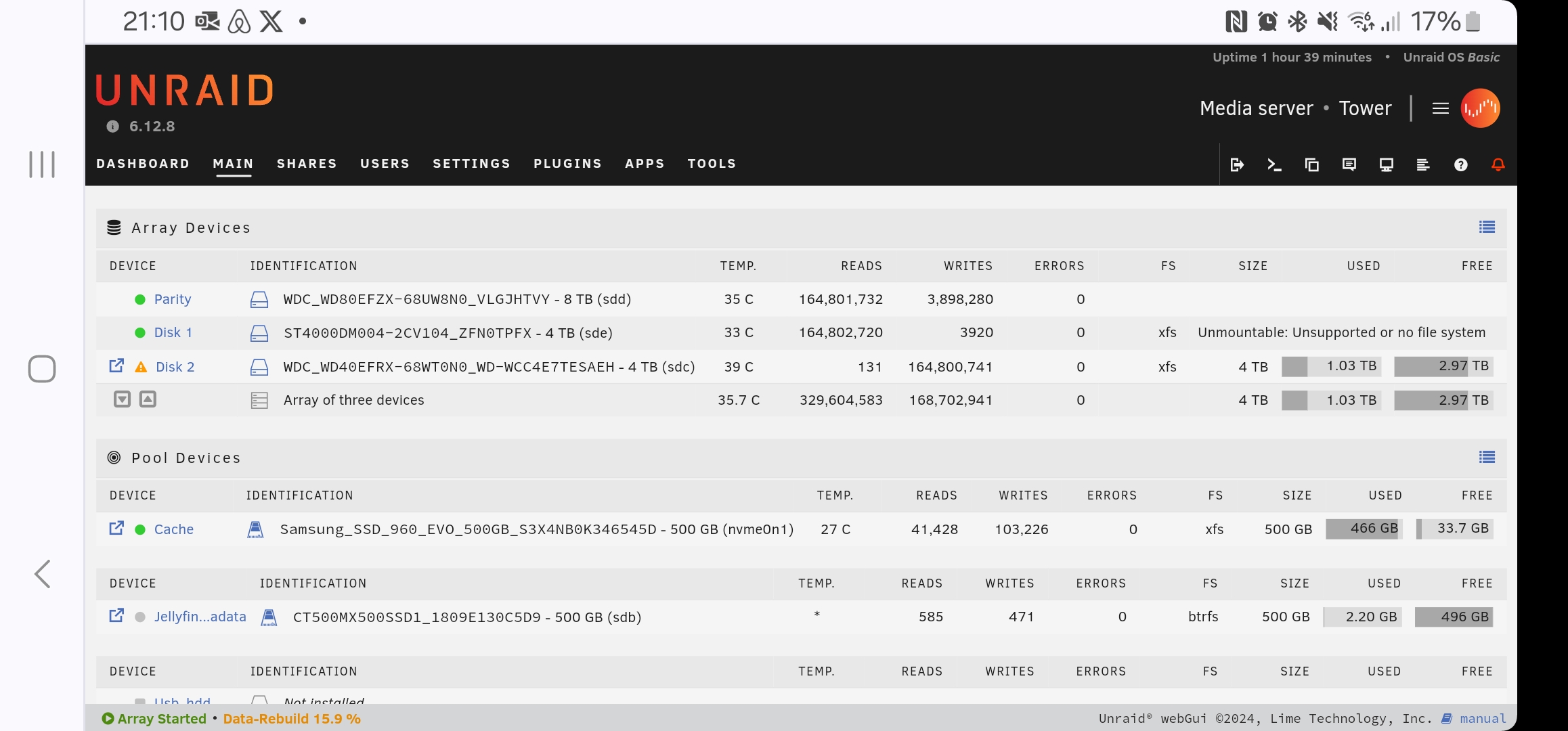

Screenshot_20240226_211058_Chrome.thumb.jpg.b306419a31ceb7c3312ebf2fd4acaa26.jpgHelp. I messed up while doing a rebuild on one of my drives and cut power midway.
Now the other good drive is saying it is unmountable.
If I let the rebuild complete can I get the data back from the other disk that says its unmountable?
I have 1x 8tb parity drive and 2x 4gb in array
New to unraid
Emulated disk2 is mounted and has plenty of data. Rebuild seemed to be going OK.
Should be OK. At least, letting rebuild complete shouldn't make it any worse than it is. We can check filesystem on disk1 after.

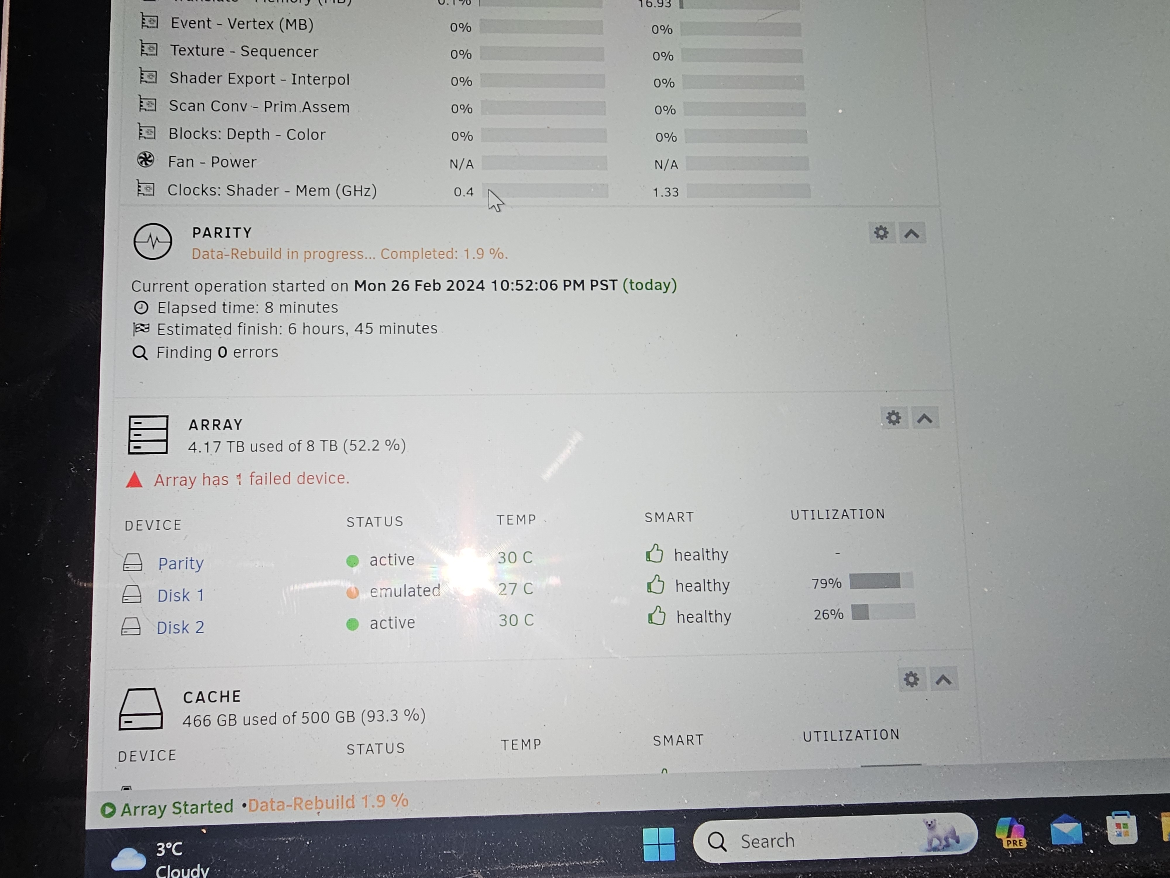

Hi thanks for the reply. I have let the data rebuild on the disk 2 . Stopped the array and started in maintenence mode and checked disk 1. It came back to mount and unmount.
I tried the repair and didn't like it . So I tried the repair with deleting logs and is now doing a rebuild. Does show my data so will let that finish and hopefully that will sort it.

Yea I know that I don't need to use larger disk for parity. More for future upgrades. Plan on putting larger disks in future20240227_070013.thumb.jpg.7b1b7570fd6addaa66231cac0e19dc17.jpg
I don't understand why you are rebuilding disk1. It wasn't disabled. All you needed to do for that disk was check filesystem.
Attach diagnostics to your NEXT post in this thread.
Just some forum advice. Please post screenshots and not photos.
Hmm OK. After I did the disc check with -L it showed data on the disc. And tried start array and that's when the rebuild started.
Might not of done it correctly or right process. Not really sure to be honest still learning.
Hopefully it will be OK. No critical on the drive just bit of a pain to re download
You must have left some things out of your explanation. If the disk wasn't disabled/emulated, it would not be rebuilt when you started the array.
Did you perhaps unassign the disk?
Ahh yes I think I might of got confused with mount and unmount and unassigned and assigned. I guess they are different?
I didn't really have a lot of time this morning and wanted to get it started before I went to work.
It is still going now but my file structure is the same as before. So hoping it will be fixed even if I have done extra steps
