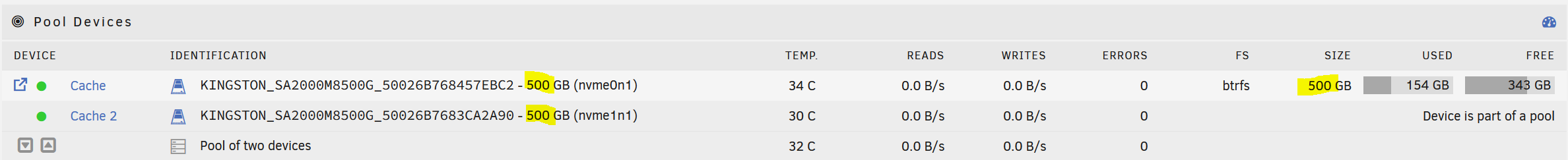

It's a good idea to double up the NVMe and SSD so that they are mirrored.  Use two NVMe as Cache1 and two SSD as Cache2 or use the NVMe and SSD you have today as Cache1.  Use btrfs as the file system (keep it simple and avoid ZFS for now).  All cache devices in the same pool are mirrored with btrfs (see below).
