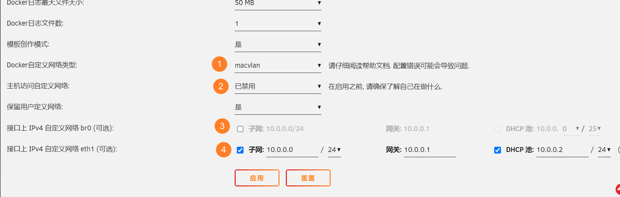

The configuration is similar to this:
Docker network only has bridge and host. What's the reason? In version 6.11.5, it can run normally according to the description in https://www.jackiewu.top/article/how-to-solve-macvlan-and-ipvlan-issues.

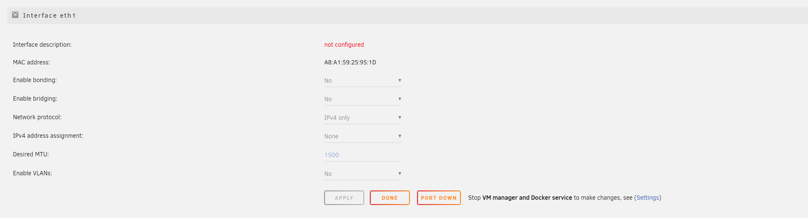

Because of the language cannot see if bridging is enabled or disabled, can you confirm? To keep using macvlan you must disable bridging

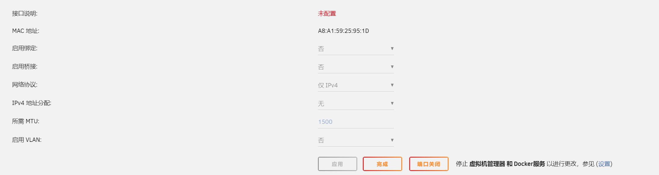

Bridging of eth1 is turned disabled.  I think this should solve the problem of lost connection.
But I don’t know why the custom network set through the docker settings WEB UI cannot take effect and can only be created through the docker network create command.

This is my eth1 configuration.
