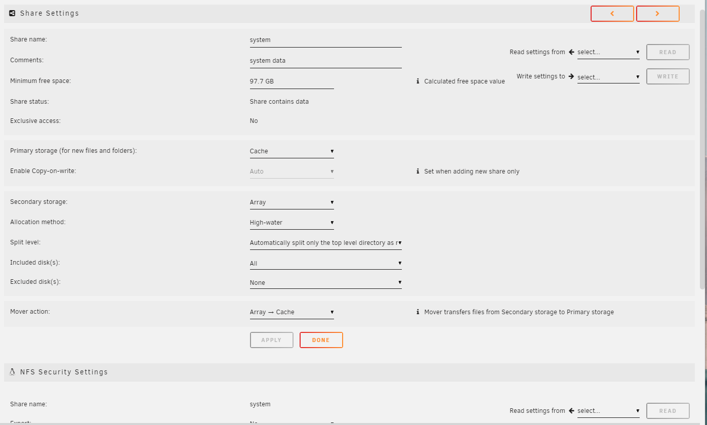

So to fix this i need to unselect the secondary storage and set to none?
No, the settings in your screenshot are correct to get them moved off the array.
But, nothing can move open files. You have to disable Docker and VM Manager in Settings before these can be moved.
Then run Mover and post new diagnostics when it finishes.
