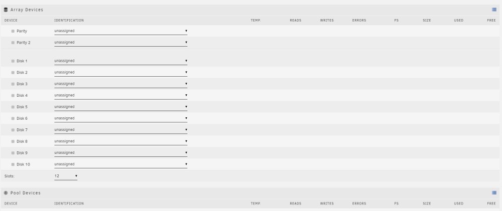

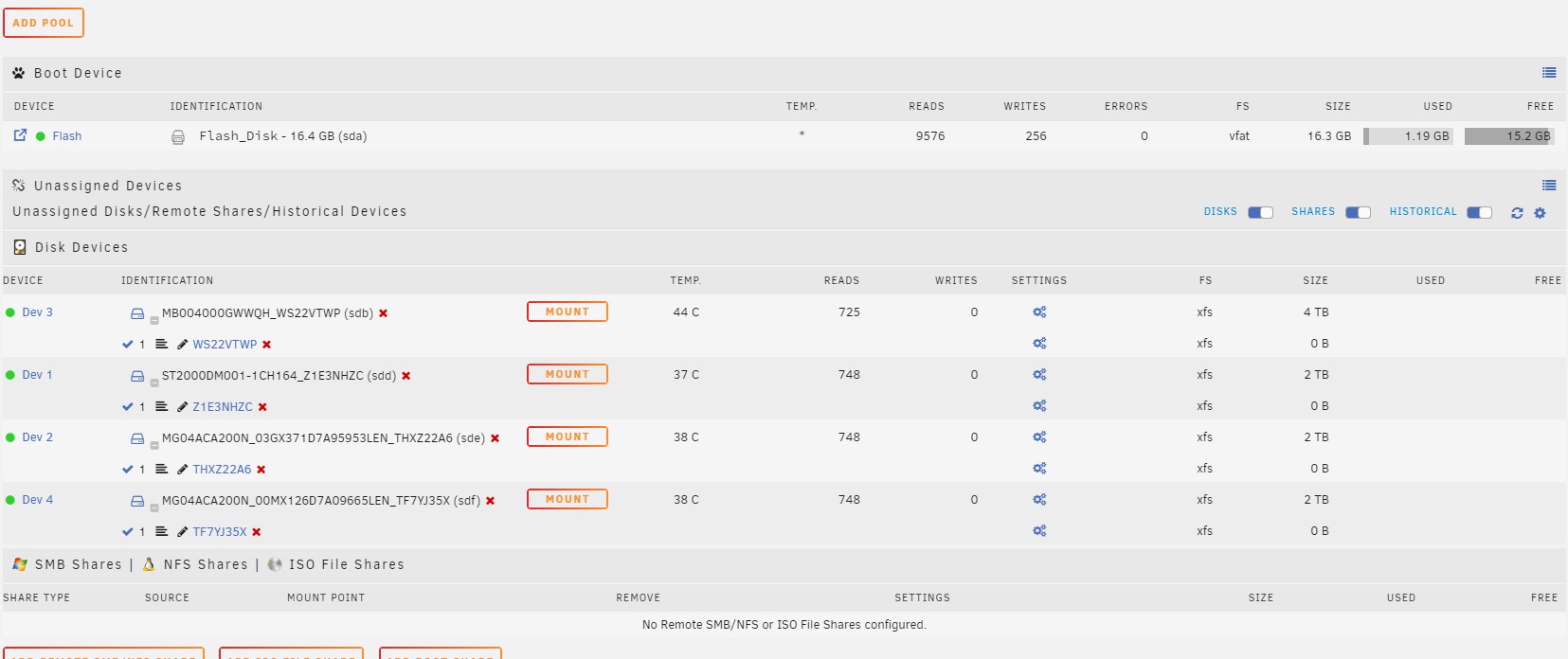

Upgrade to 6.12.8 After reboot, the array is offline and all data and parity disks are shown as "missing". The disks appear on unassigned devices, but when I try to reassign them to the array in their previous positions, they show as "incorrect".

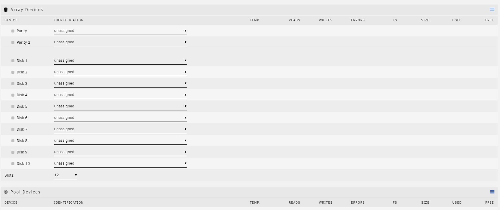

Post a screenshot of main with the disks assigned to their original slots, assuming you know them.
This suggests a possible flash drive issue, but if you now the assignments for sure, assign them all as they were, check parity is valid and start the array.
I don't have a picture of what they were like, I think I'm in trouble, right?
Hello, I did the process you recommended and everything worked correctly. Thank you
