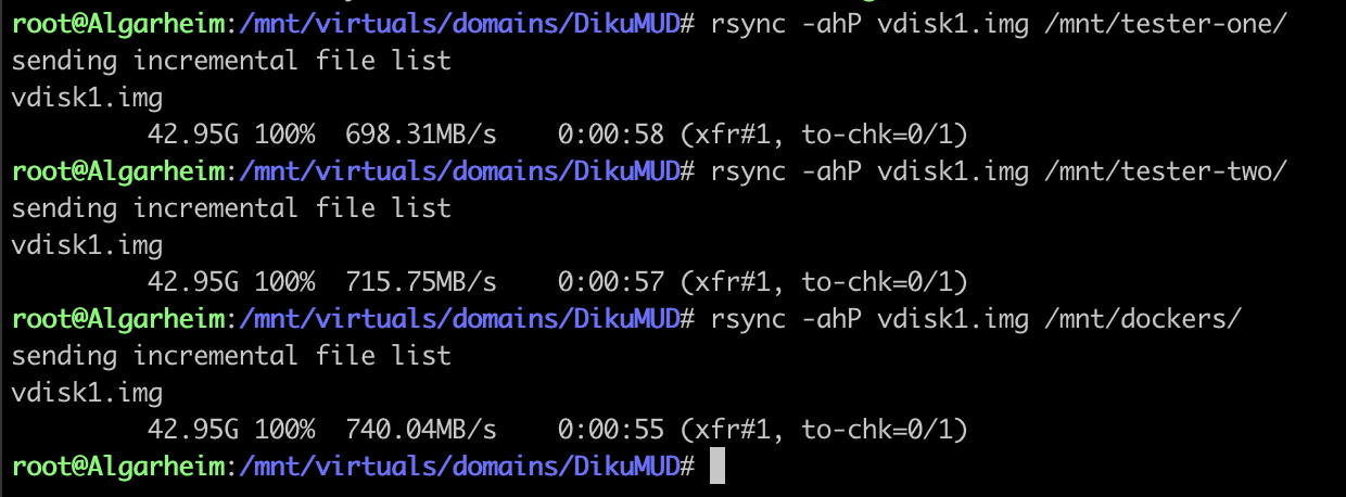

Now the response I'm getting from the system is very good, but when I tested the rig just now I belive I should be seeing better speeds. The following screenshot shows the following rsync jobs:
  • 980-Slot-1 to 990-Slot-1
  • 980-Slot-1 to 990-Slot-2
  • 980-Slot-1 to 980-Slot-2
When testing all combinations of copying between the M.2 the numbers are almost identical (to within 1%). The screenshot shows a test with disks formated with zfs-encrypted (with compression), but I have mirrored the tests using xfs with the same results.
Are there any hardware limitations I'm hitting or is this the expected level?1375790097_Screenshot2024-02-28at20_31_32.thumb.png.edc9efde9574e832da6b2fa171e0627e.png

Rsync is not really built for speed, having said that, in my experience don't expect much more the between 1 to 2GB/s, mostly depending on the CPUs single thread performance, try using PV with a large file to see if it's the same:

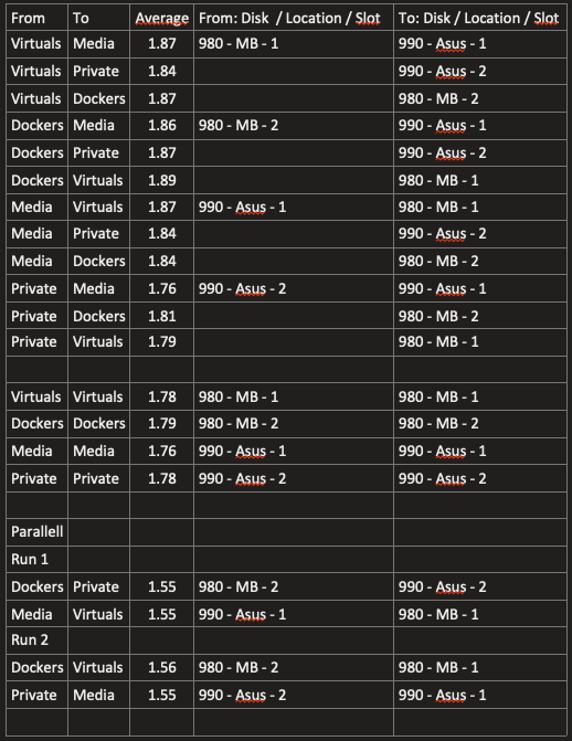

Good point on rsync, and I've redone with pv as suggested. Giving the following observations:
  • 1.79 GiB/s  between the 990's (on the asus card)
  • 1.19 GiB/s between the 980's (on the mb, one of which will be capped at gen3)
  • 1.86 GiB/s from one 980 to one 990
Better then rsync, but I am not getting much more effect from the Asus and the 990's.

I'm afraid that's around what I would expect to see with that CPU, you might be able to get around 2GB/s+ with a faster single threaded CPU, like an i5 14600K.
A more structured test using a 128 GB file:
I am not sure I follow your argument that the cpu is the bottle neck because when I run two pv's in parallell I am getting an average of 3 GiB/s throughput? Watching htop I can see that the system is hitting 4 GB/s in disk R/W pr pv job. Wouldn't this suggest something else is capping?
Edited by Ulf Thomas Johansen
That's normal, that's why I mentioned
Each transfer will only use one CPU thread.
Aha ... Makes sense.
