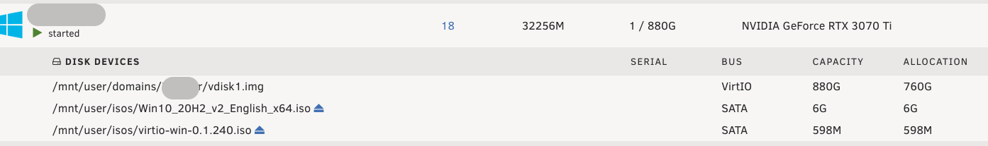

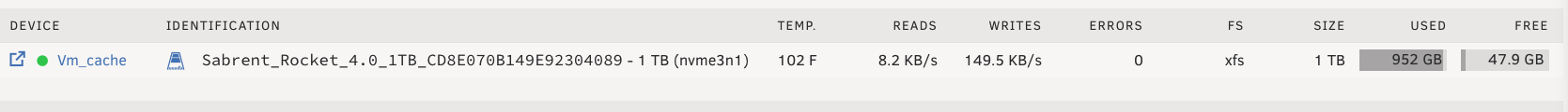

3. The vm_cache did get ~50G back in free space (yay!) But I was expecting this to show ~120G free
4. I turned on my VM and went to expand the disk (like spaceinvader did in his video) and there are 2 issues
  • It still shows ~220GB unallocated (if I expanded this full amount, the vdisk would be back to 980G size)
  • When I try to expand the disk by a smaller amount, I just get this error: There is not enough space available on the disk(s) to complete this operation.
Question 1: Why can I not expand my vdisk in Windows now?
Question 2: Why does it show >200G as unallocated, not 880G (vdisk size) - 760G (c drive size) = 120G?
Question 3: Why does the vm_cache not show more free space? There is only 1 vm using this and it is 880G in size.

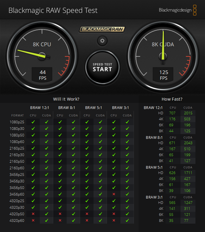

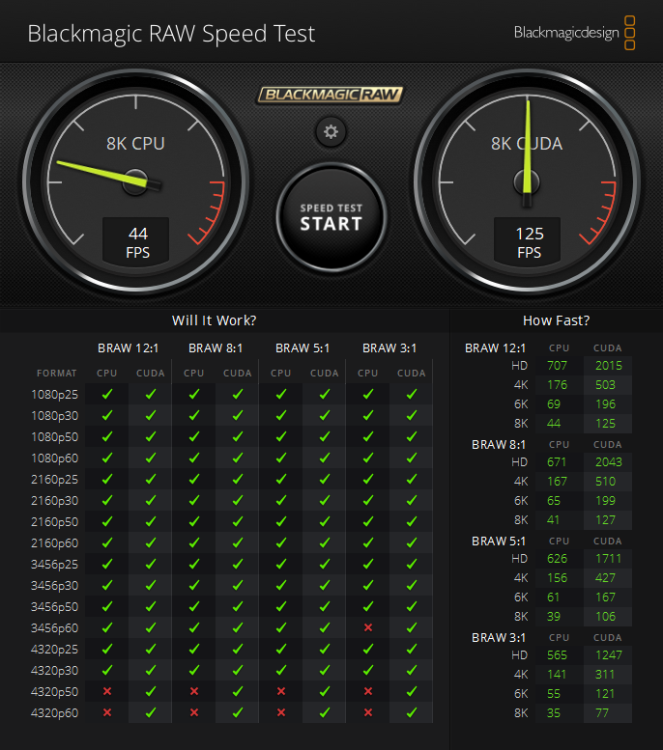

I'm assuming that something from above (or another configuration issue) has caused my VM to experience some significant slowness in write speeds.  I'm trying to do some video editing and should have plenty of resources to run either Davinci Resolve or Premiere Pro, but both programs crash frequently with my current setup.
Question 4: If the above is not causing the slowness, how do I determine WHY these programs continually crash? What can I do to fix this?
