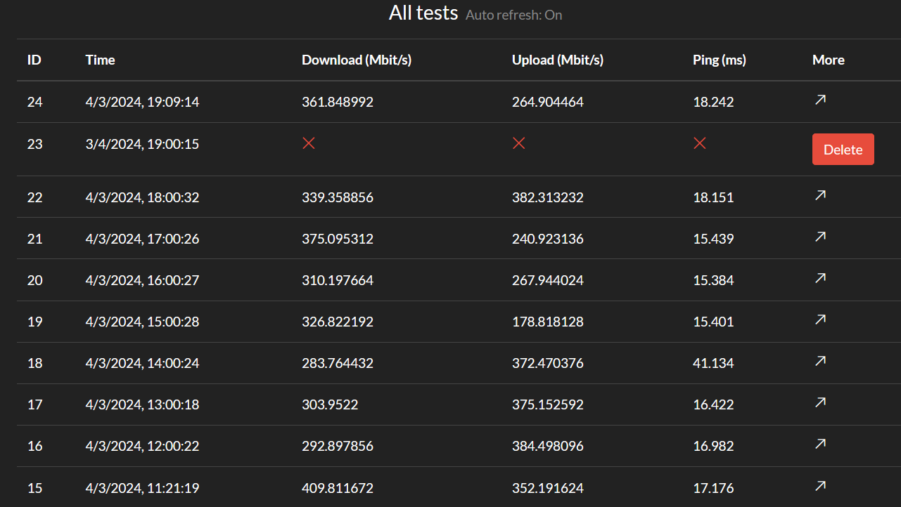

Hi, I changed to ipvlan and I'm having again the same unresponsiveness issue. I have attached the diagnostics file downloaded just after a hard (button) restart of the server. I have a speedtest running every hour and I can see that tit was running flawlessly until the one at 19:00 when the server was unresponsive. This means it is a network error as the proceses and dockers were still alive.
This errors stared with v6.12.3
What can I do? I'm going to be 1 month in the abroad and I will no have any way to restart the server with the button and I'm pretty sure it will no last responsive for that long....

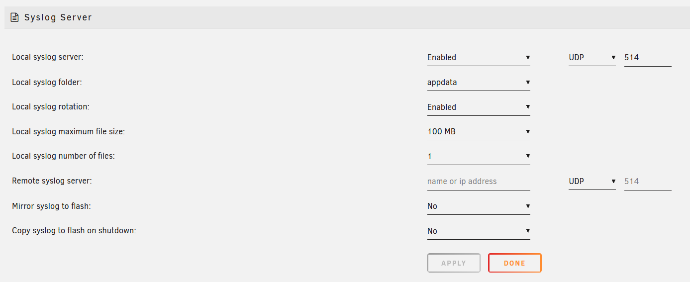

Syslog starts over after every boot, enable the syslog server and post that after a crash.
On 3/14/2024 at 10:07 AM, JorgeB said:
You didn't post the persistent syslog from the syslog server.
 I have activated:
But there is no file in appdata.
You have to specify which server to send the syslog to. Put the IP address of your Unraid server in the Remote syslog server field.
Thanks
