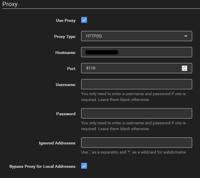

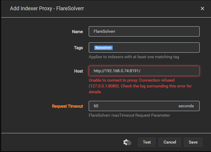

I have multiple binhex containers sonarr, prowlarr, radarr etc all going happily through the binhex-qbittorrentvpn. I have replicated the network settings for flaresolverr but I continually get this error when going to test it within Prowlarr:
"Unable to connect to proxy: An error occurred while sending the request.. Check the log surrounding this error for details"
Reading the log for flaresolverr and it appears to be up and running and waiting for something to do.
@binhex , would you mind giving a breakdown of how you were using flaresolverr and byparr on the same network as privoxyvpn? Did you mean flarsolverr for example was using --net=container:binhex-privoxyvpn? If so, I cannot get this to work inside prowlarr. The privoxy is up but flaresolverr can never get through and times out.
I've tried the wireguard and openvpn setup with PIA and put port 8191 in the input, but to no avail. Am I misunderstanding?
Would love to understand what I'm doing wrong!

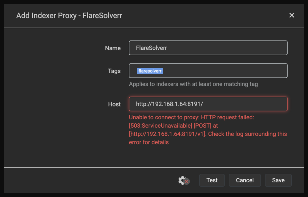

I have been running my binhex-flaresolverr behind my binhex-delugevpn container for some time. Just recently I noticed that it is failing to work with Prowler (also running via binhex-delugevpn). It results in a connection refused every time. If I move the binhex-flaresolverr out from behind the binhex-delugevpn it works fine.
I am a bit lost as to how to troubleshoot this as there isn't any useful logging showing why it fails.an
I can curl flaresolverr from my Prowlarr container just fine:
sh-5.3# curl http://192.168.xx.xx:8191
{"msg": "FlareSolverr is ready!", "version": "3.4.6", "userAgent": "Mozilla/5.0 (X11; Linux x86_64) AppleWebKit/537.36 (KHTML, like Gecko) Chrome/143.0.0.0 Safari/537.36"}sh-5.3#
