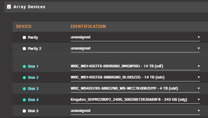

i want to exchange a disk at my unraid server. But i dont understand what problem there is going on.

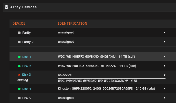

I want to replace disk 3 with an new 20TB disk, if understand it right if have to set it to "no device"
But then it says missing, if i now install the new disk and reboot, then add it to disk3 it says wrong?
What am i missing here?

Since you don't have parity you need to do a new config first: Tools - New config.
Will that new config kill any configuration? Or is there something i have to do with this? Never used new config.
Not the data, it will reset the array assignments and some other things, like default filesystem, any custom temps and few more things, but all data remains.

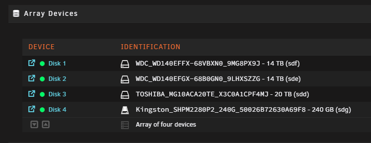

Thank you, worked out very well :)
