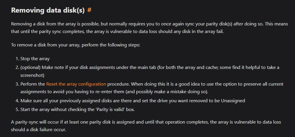

Hi, I follow this guide in unraid to remove the data disk. I didn't copy the files from the drive I want to remove. The drive, however, left untouch in the "unassigned disk" unmounted. I checked my files and there were missing files. Should my files comes back after the parity sync?
No - as mentioned in the text you posted that procedure invalidates parity.    You need to copy the files off the old disk
