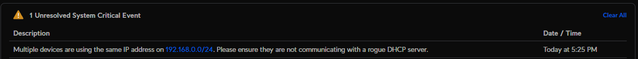

Hello,
Just switched to a Dream Machine SE and I am getting errors about a duplicate IP. It's two mac addresses both owned by the unRAID server.

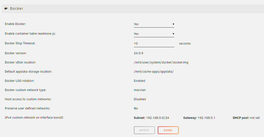

The stuff I've found online mostly points to disabling "Host Access to Custom Networks" for docker which was already disabled:

Thanks! I'll try out those settings you recommended. I am currently using:
Docker Settings:
Docker custom network type: macvlan
Host access to custom networks: Disabled
IPv4 custom network on interface bond0: Subnet: 192.168.0.0/24 Gateway: 192.168.0.1 DHCP pool: not set
Network Settings:
Enable bridging: No
Not sure if my IPv4 custom network setting with change to eth0 at some point but it's bond0 now. Other than that it just seems I need to enable bridging and switch to ipvlan. However, I'm still unclear as to what the duplicate IP is trying to host as I can access all of my dockers and VMs without issue. It pops up and goes away after like 4 minutes too which is weird.
