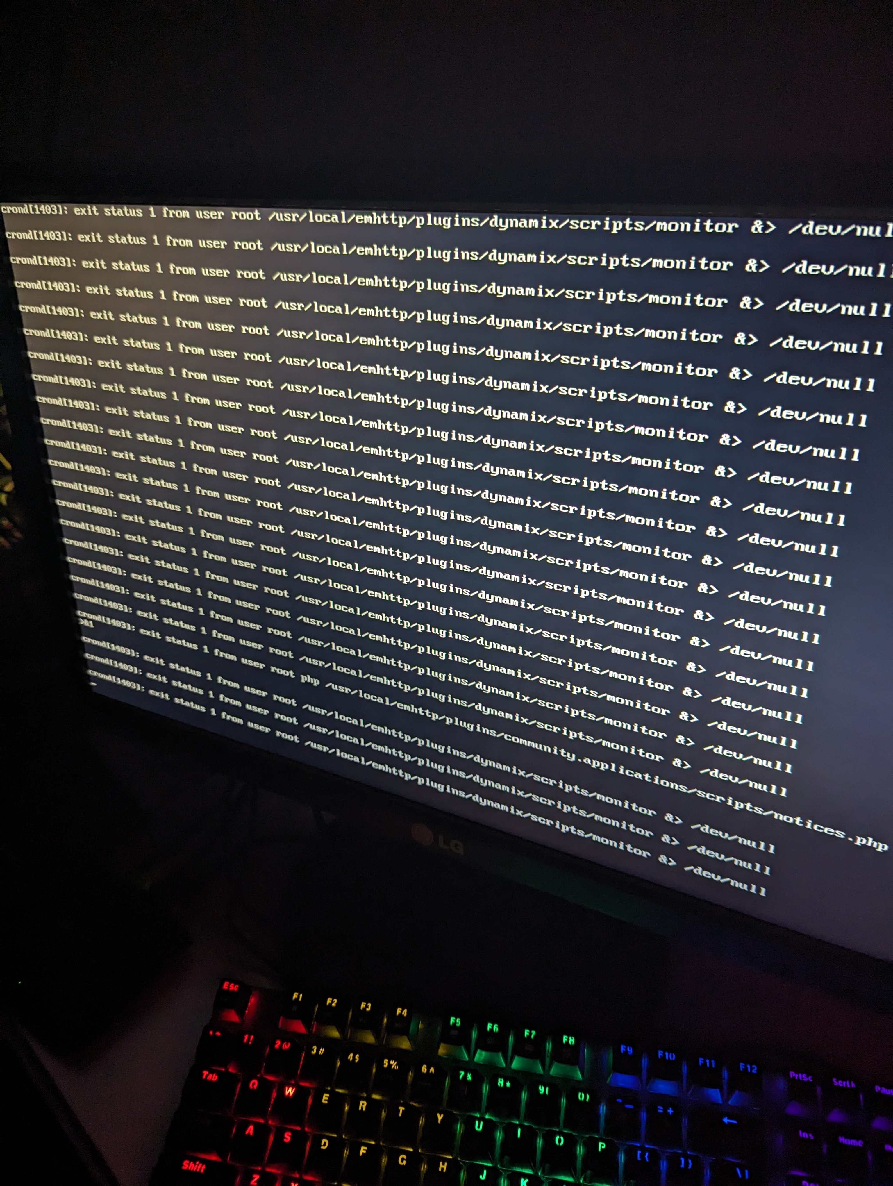

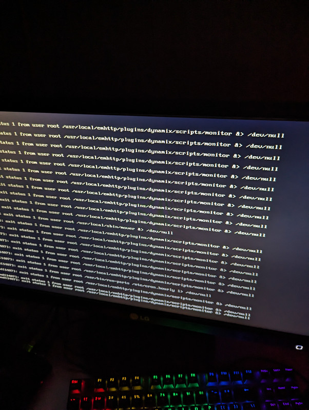

Hey folks, I'm fairly new to Unraid (only a couple weeks now) and I'm occasionally getting an error and when it happens, I can't reach my Unraid server and have to reboot it.
The error is:
exit status 135 from user root /use/local/emhttp/plugins/dynamix/scripts/monitor &> /dev/null
Sometimes it's exit status 1.
Here are two pics of what the display on the Unraid machine looks like when it happens (I usually don't discover it until a couple hours later or whatever).
I have no idea and my searching hasn't yielded any information either - except for an old post on a slightly different issue that was never resolved.
I ran phpdbg on that monitor script and it came back with "successful compilation" so I'm at a loss of what's going on.
Unraid 6.12.8 - fresh install and setup.

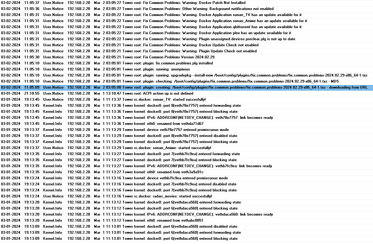

Okay so the error happened again and it appears to be network related. Plex. Sonarr, qbittorrent, etc were available for a while afterwards but it's all unreachable now. I took a screen grab of the log because for some reason it stopped writing to the file after the highlighted line. I found something about that 'fix common problems' plugin so I gave it a whirl but it didn't do anything other than advise of a few updates.
I also attached the logs from yesterday after I had rebooted after resolving that flash drive issue - towards the end it seems that something similar happened overnight.
The weird thing is I have no logs from the end of that file to this screenshot. This screenshot is all I have from today - I wonder if because I'm losing network I'm losing the logging as well? Makes sense I think. I've switched to local logging on a share but I'm gussing mirror to flash might be the best way to capture the issue?

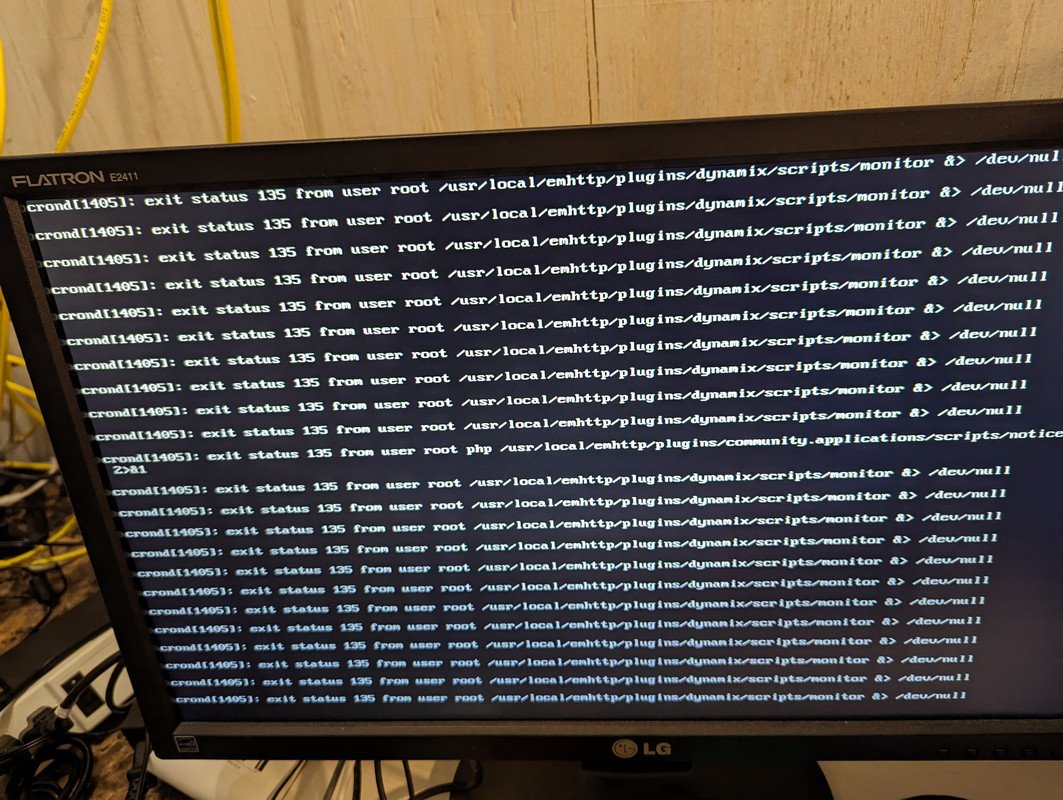

Edited to attach a photo of what the monitor on the Unraid PC is showing before I reboot it.

I'm having something similar happen. My unraid keeps going unresponsive every couple days since I've updated to 6.12.8. I have my logs forwarded to a log server and I didn't get any logs. I've just ran a memtest86 all the way through and I'm getting 0 hardware issues. If you look around you'll see there's quite a few people having these random crash issues since 6.12.8 :/
Found something recent related to your NIC, don't know if it will help or not.
My system just went down again - logs don't show anything for the past few hours and I'm not getting that same fatal ethernet error as that NIC post. Really scratching my head on this one and it's driving me insane.
I tried my second ethernet port but it's not even being recognized.
Just an update on this - I had read a couple days ago (can't find the post now unfortunately) but it had mentioned crashing regularly so they removed and reinstalled the Unassigned Devices plugin. I have removed the plugin (and not reinstalled it) and it may be too soon to celebrate - but I'm over 24 hours of uninterrupted uptime now.
