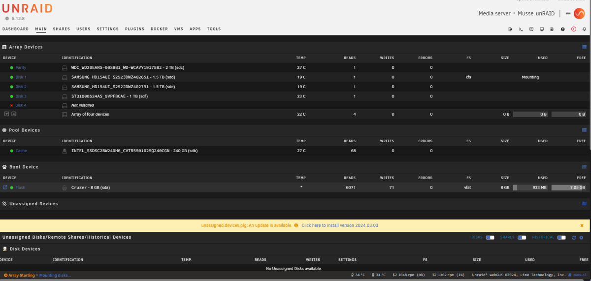

It seems to me that somehow I cannot do anything as long as it's stuck in this "Array Starting * Mounting disks"
Am I missing something?
I didn't notice before that you have a disable disk, with a disabled disk you cannot remove parity, at least not without losing the data on that disk, has that been disabled for long? Do you know if there's any data  there? Do you still have the old disk?

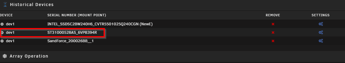

The "5th-drive" is actually in the istorical devices

It cannot be brought back from the historical devices?
No, but if you still have the old disk you can see if there's any data there.

It seems that I cannot do anything as long as the array is "Starting"
