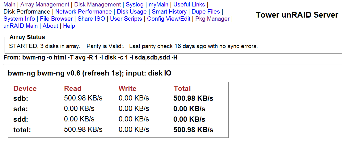

Oh and I went on unmenu to Disk Performance to look at the read speeds while I play a blu-ray, and I would get between 500kB/s and 1000kB/s.  I also played a recorded TV show off of disk2, and got the same read speeds during the laggy playback.  I attached a screenshot.

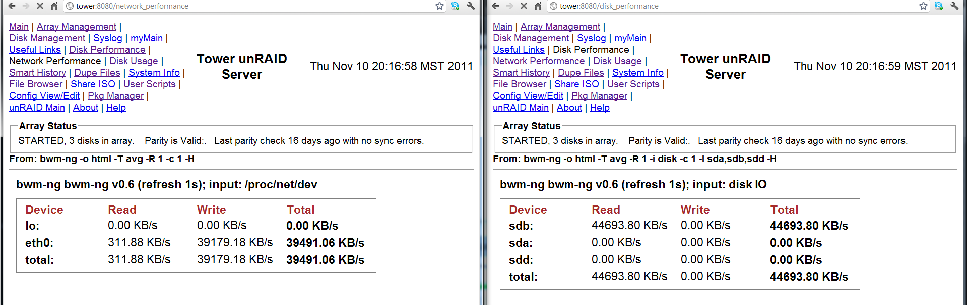

As I showed before, I only get from 500kB/s to 1000kB/s when I'm playing back a blu-ray.  But when I transfer a file from the unraid server to the HTPC, I can get much better rates (attached).  That doesn't make much sense to me.
