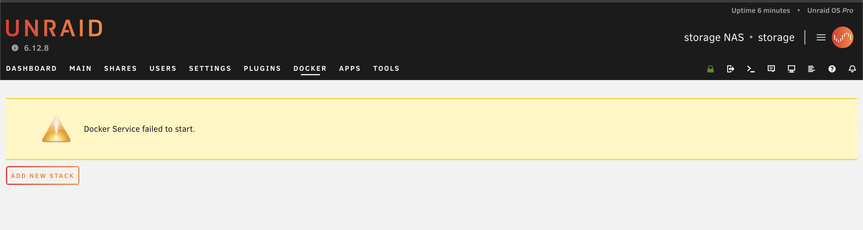

Do you have a screenshot where it is telling you it is failing to start?

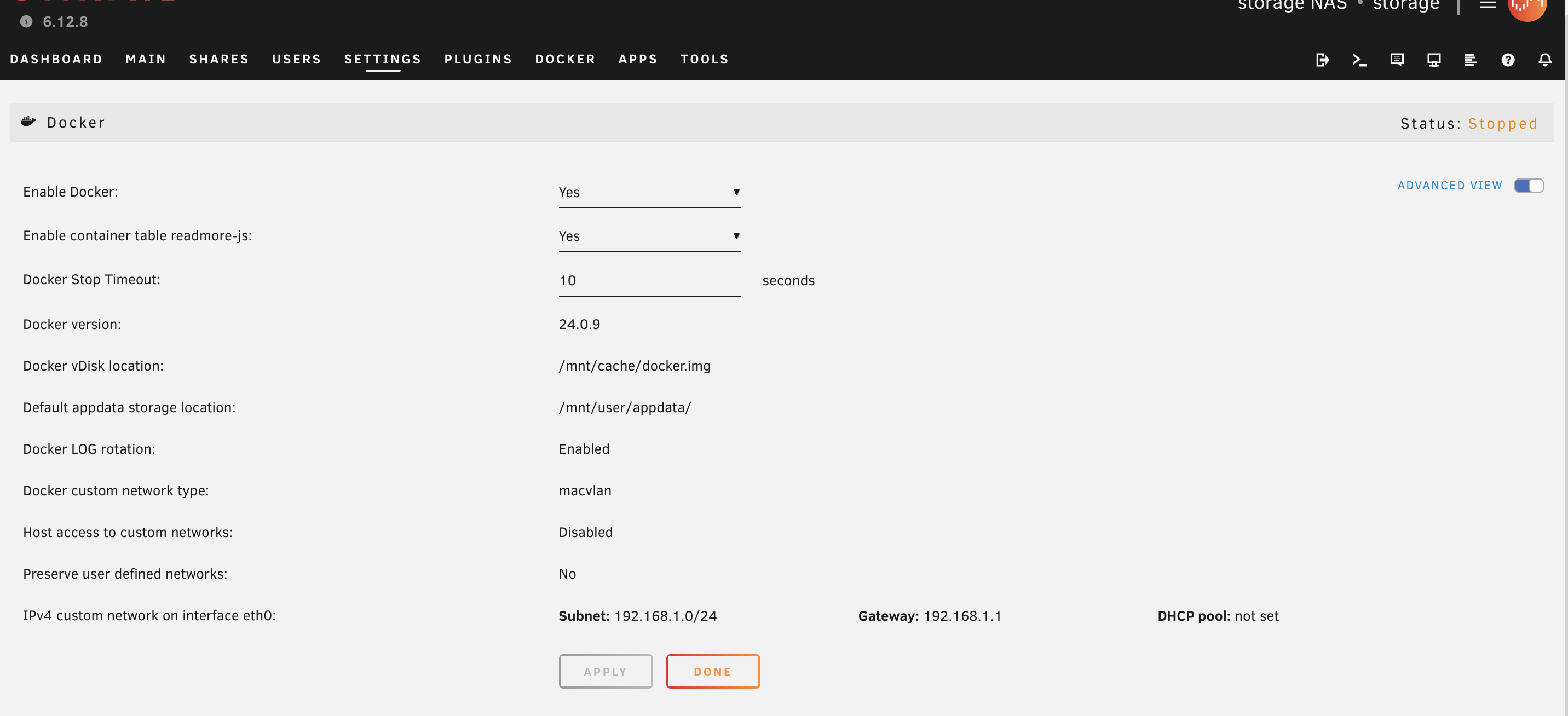

The service just doesn't start on a reboot.  Docker config showing it is enabled, but the status at the top says stopped.  I have toggled the "enable docker" option to no/yes but same issue persist.
