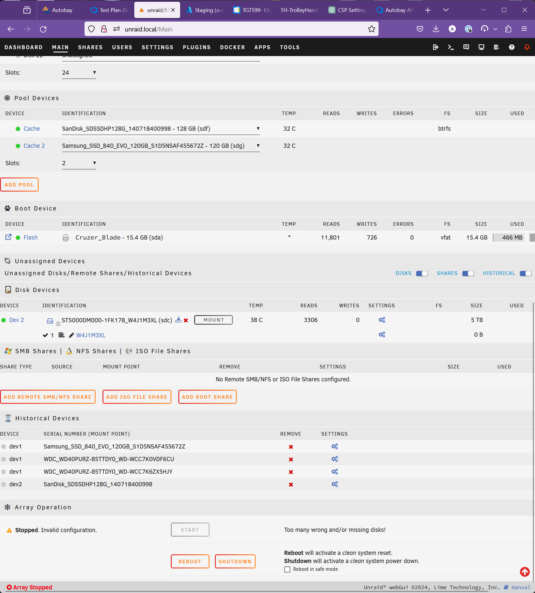

Another update. So I decided I need to run some kind of full disk check prior to adding them back to the array, don't want to go through this again.
found this video about preclear, seems as good as anything
*Do you have any suggestions/better ways to do a full and complete disk check (and ideally get SMART to 'know' where the bad sectors are and ignore them)?*
The plot continues...
So, the array said Disk 1 was in need of a format, but I...
stopped the array
set 'disk 1' (the problem disk we have) to 'no device' on the array
start array
'unassigned.devices.plg' showes both the Parity Disk (5TB) and the problem disk (4TB) now.
I clicked Mount on the 4TB problem drive
can browse folders.
using Krusader as setup here (
and I can access my files, which is great.
the only real downside is having to setup all my dockers again since I didn't know this was avaialble until after they were half setup, but oh well.
thanks for your help.

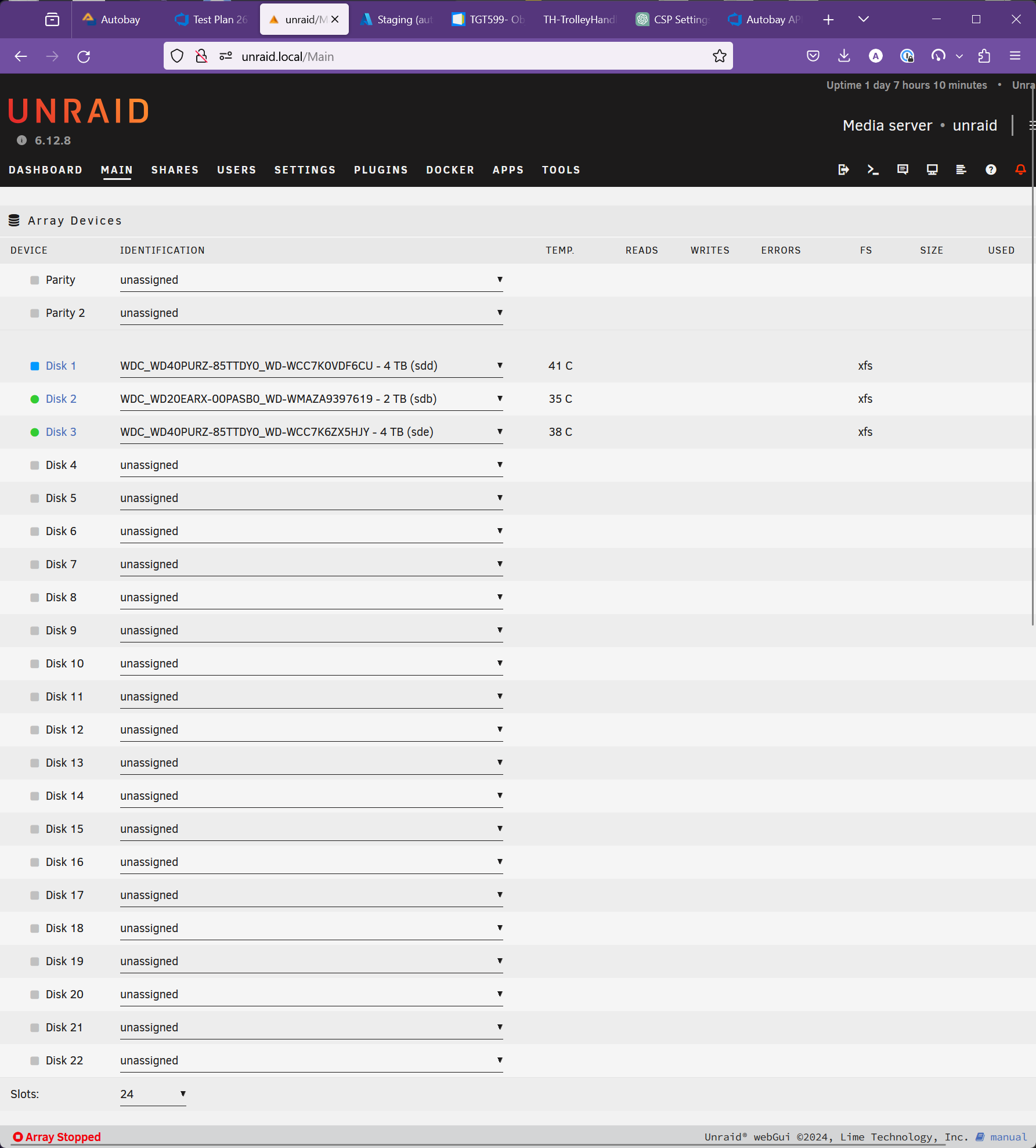

@JorgeB
could you perhaps assit a little more, so i've got my data off as documented above.
However, I can't seem to 'fix' the array.
I've done pre-clear on both my 4TB and 5TB drive, both are fine.
so I just want to put them back in the array but whatever I do, It just says "Stopped. Configuration valid."
Things I've tried
1. Doing just 1 drive edit at a time
- adding parity back, nope
- adding disk 1 back, nope
2. Going to Tooles-> new config
- with and without preserving anything, no chages at all.
any help with this hopefully final hurdle appreciated.
unraid-diagnostics-20240307-1713.zip
I should add, I can start the array, and disk 2 and 3 work fine.
Do a new config - Tools - New Config
Thank you, face plant moment, didn't press 'yes' and 'apply', just clicked 'done', hence it doing... nothing... doing to many things, thanks for your help, much appreciated.
