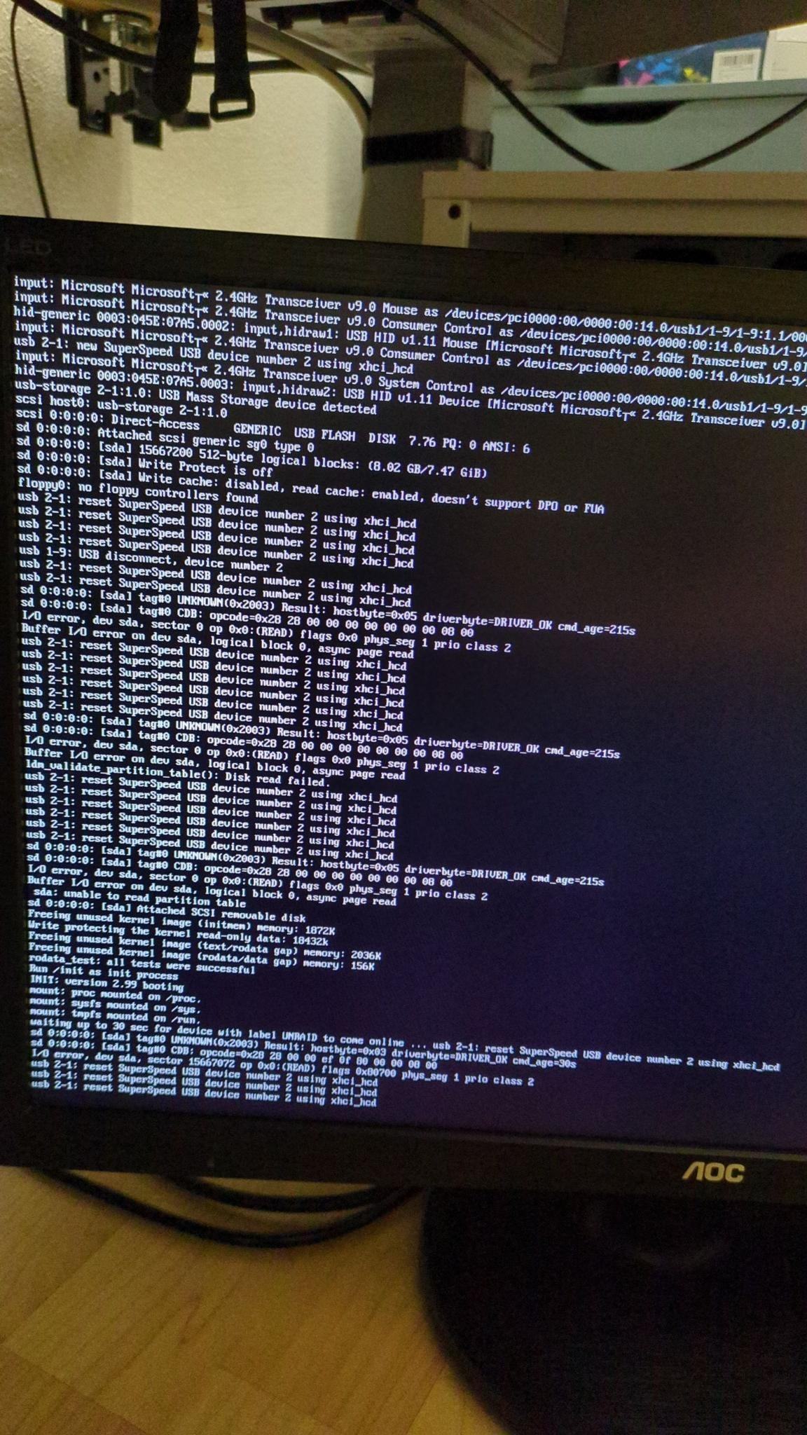

Hello guys, hopefully somebody in here can help me with this.
My friend convinced me to go for unraid for my server replacement.
I was really struggling but finally i managed to get it running, but what I have to do to get it running can't be the solution.
I already tried multiple different USB sticks and USB Slots on the mainboard, always with the same result.
unraid will never get over the screen on the photo, until I unplug and plug in the usb stick, after this it magically can move on.
What can be done for this issue?

Check for bios updates, do you have fast boot enabled? are you booting uefi?
I already flashed the newest version of the UEFI. Now it is running on 7.03
My mobo ist:
Mainboard H610M-HDV/M.2 R2.0
https://www.asrock.com/mb/Intel/H610M-HDVM.2 R2.0/index.asp
I already tried with fast boot enabled and disabled, same result.
I already followed this article:
https://docs.unraid.net/unraid-os/getting-started/advanced-bios-config/
What do you mean with "are you booting uefi?"
this option? if you mean this, yes it was ticked.

Yes also check CSM is not enabled.
These are from the manual for the MB.
CSM Enable to launch the Compatibility Support Module. Please do not disable unless you’re running a WHCK test.
Have you tried different settings for the option below?
Legacy USB Support Enable or disable Legacy OS Support for USB 2.0 devices. If you encounter USB compatibility issues it is recommended to disable legacy USB support. Select UEFI Setup Only to support USB devices under the UEFI setup and Windows/Linux operating systems only.
to enable CSM i have to install an external gpu, i think this is not the right setting
with "Legacy OS Support for USB 2.0 devices" disabled I can't use my USB keyboard any longer to do stuff in the UEFI.
I had to reset the cmos to have again my usb keyboard available in the uefi
Edited by nevane
I just tried another USB stick, the oldest one i was able to find, and it finally boots without unplugging it.
How bizarr is this?
