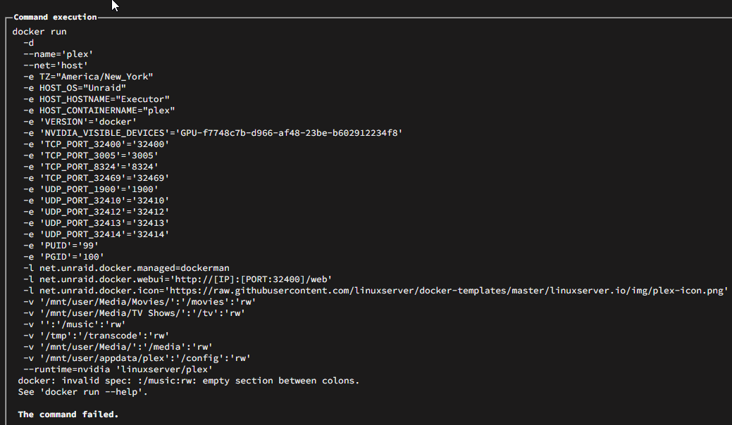

I just upgraded from 6.12.4 (I think?) to 6.12.8. Upon reboot, plex docker is gone. Attempting to reinstall via Previous Apps results in this error:

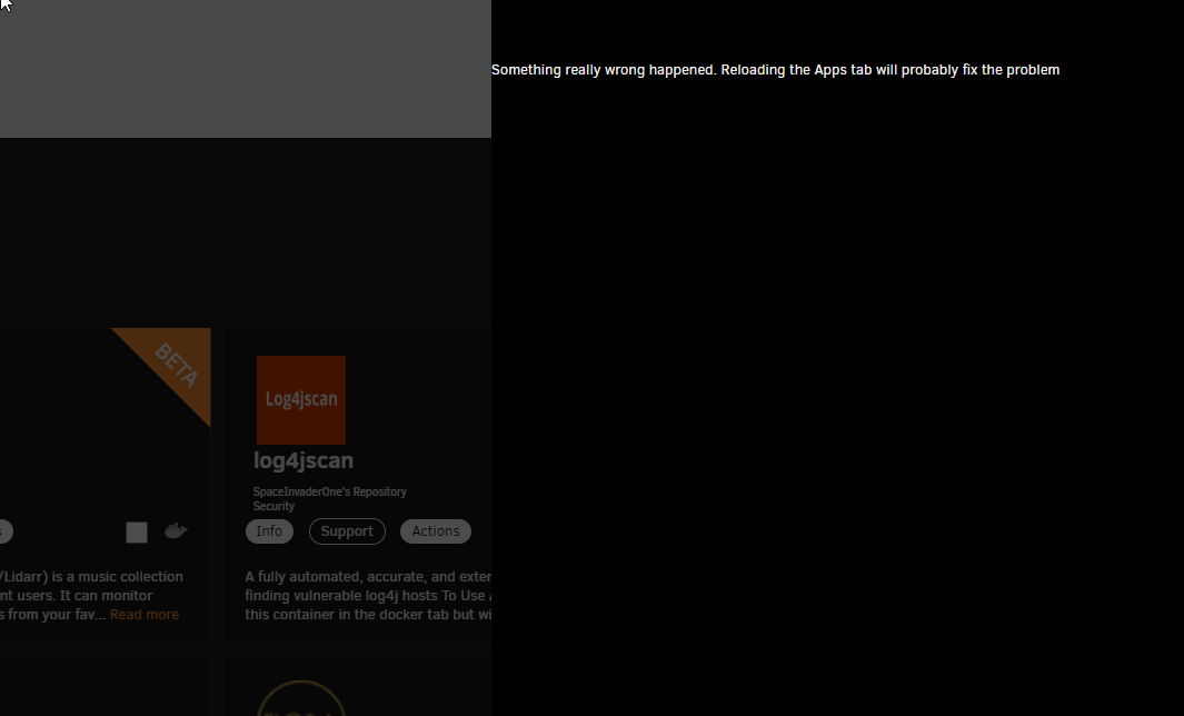

Also, maybe unrelated, after clicking DONE, I get this error:

OK, so for whatever reason, a valid music directory is required (I never had one set up[ in the past). I supposed I could have just removed that parameter as well.
