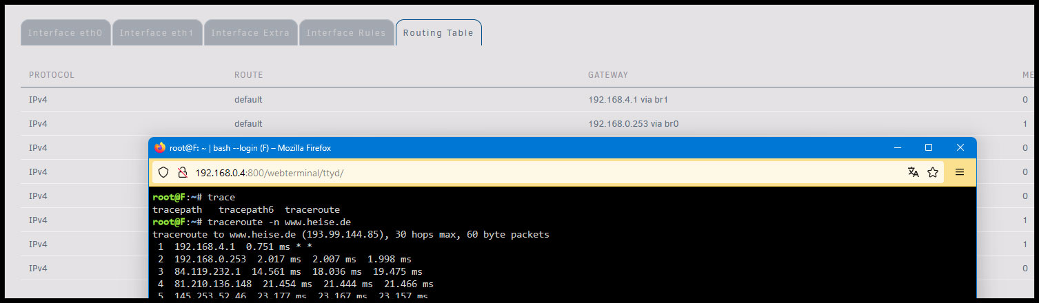

So I've put in 0 as the metric, but this results in
The default route is generated (should not happen) and even used with higher precedence (should also not happen).
All packets are send to the wrong card first and only after getting back and error the card is switched and connection retried.
This results in a lot of delays when opening new connections.
So: is the info page wrong ("0" does not turn off, it even gives highest precedence. So the opposit of what you want happens), or is a script later on wrong that does generate the default route even if it should not ?
And, most important question, how can we turn it off??? (I could either give a metric of 65535, or hope that somebody fixes the script someday)
