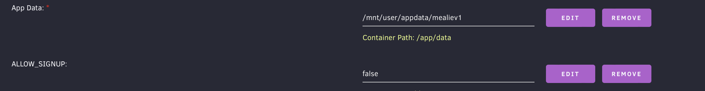

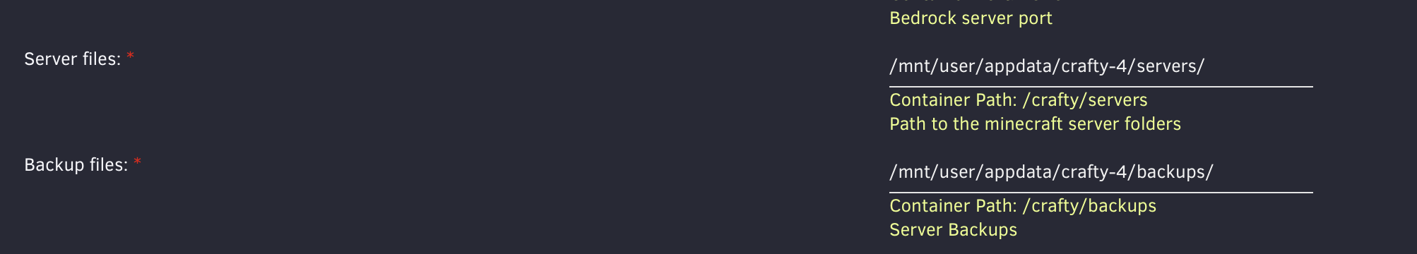

I think I have found one big problem. For a lot of containers, I configured them such as here for crafty (Minecraft-Server-Manager).

*Or such as here
