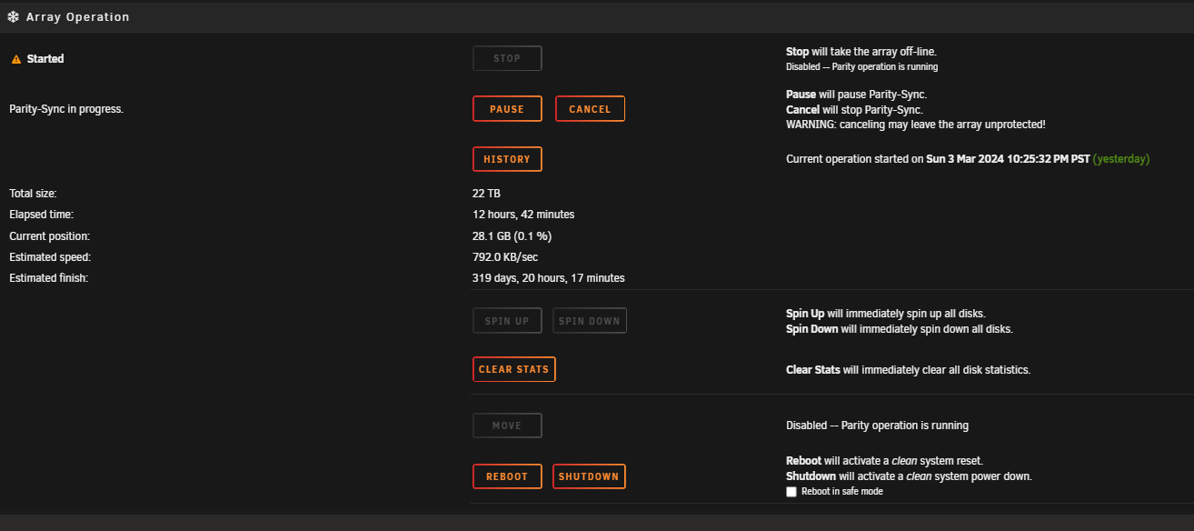

I recently had a drive failure so I purchased a 22TB drive to replace my failed 8TB drive.  I originally had 22TB and 8TB drives in the Parity 1 and 2 slots.  So in order to use the 22TB drive to replace the failed 8TB drive I used UNBALENCED to remove all of the data from the 8TB drive (which was emulated at that point).  Then I proceeded to New Config to remove the 8TB Parity drive and add it to my data drives.  This worked great........With one exception.
The new Parity Sync is running at a snails pace.  Hell at this point, the snail is going to win the race...lol
Parity sync speeds as slow as 250kbps with a high so far of 1.3mbps As you can see below.  I have used the docker app diskspeed to test all the drives and they check out.
I am more likely to have another drive failure before this Parity Sync comes to completion.

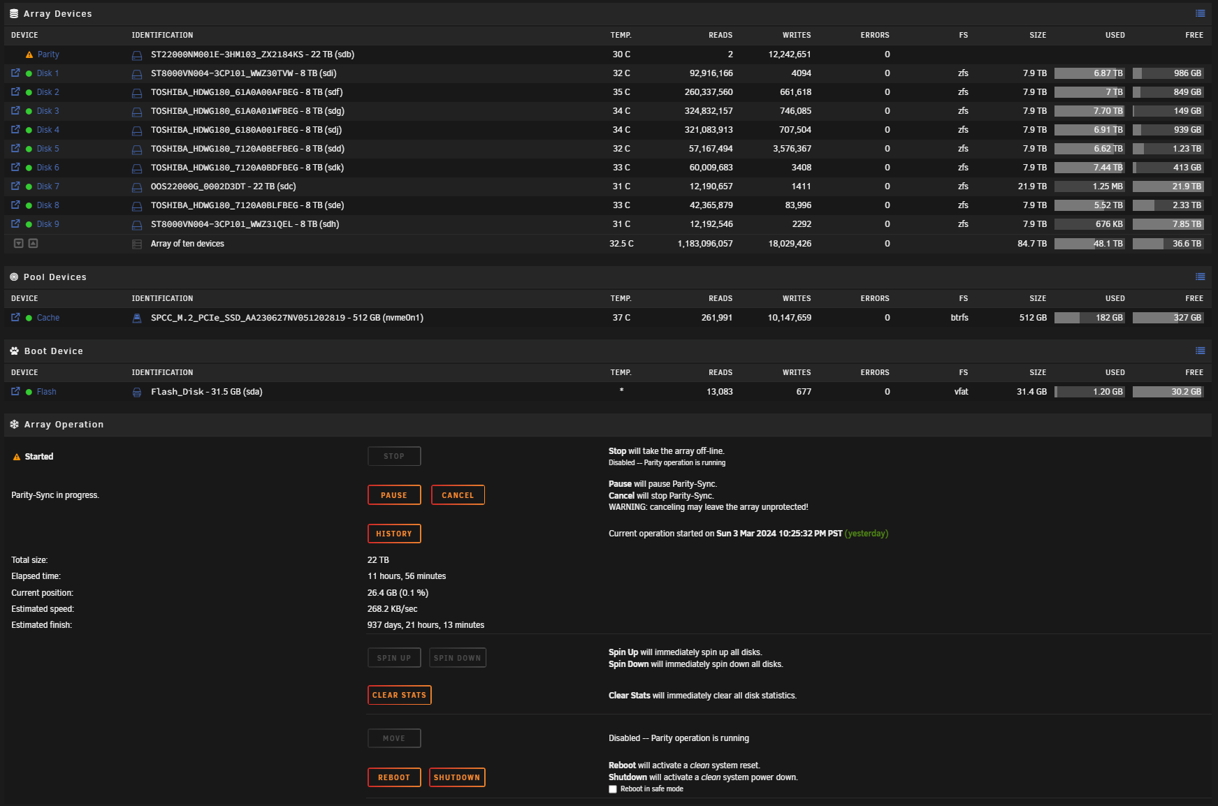

There's something else reading from multiple disks, and also some writes to disk4.
At present, yes, I do have Plex updating the library.  BUT I have disabled them before and there was no changes in speed.  I will disable them again and upload a new diag in a few minutes.
It can take a few minutes to stabilize.

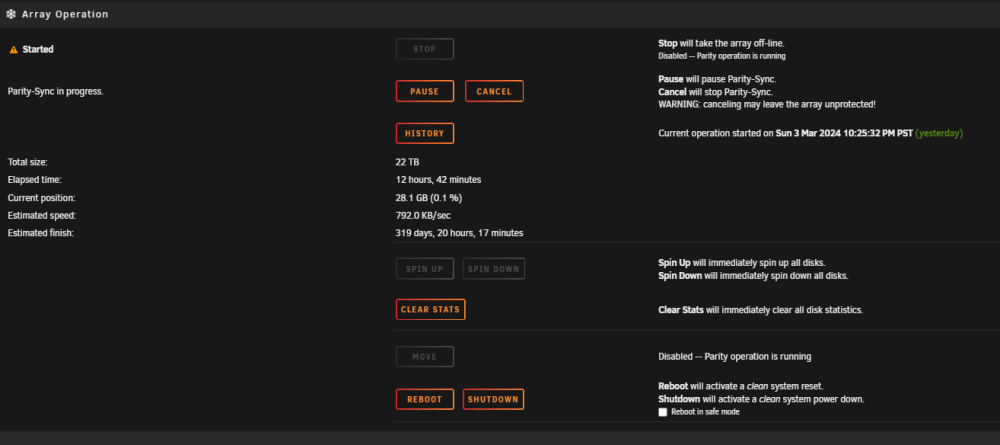

As you can see, it has sped up by 500kbps and cut my sync in half to 300-400 days but that is still a bit slow...lol
Disk2 and disk3 are still getting a lot of accesses.
