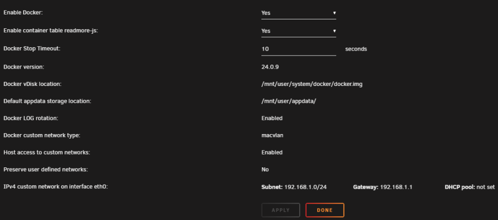

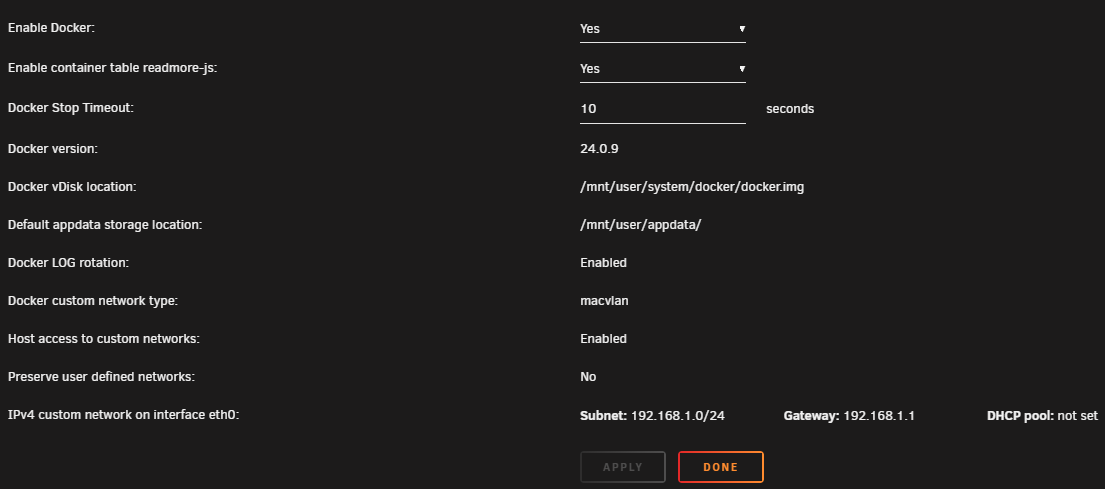

Further to this, I have installed the apcupsd app on windows and it can connect to the apcupsd service on unraid so the unraid host side is good - just the docker container cant connect.  And it did work until last reboot.
I found a solution for this online - BUT IT IS A BUG - PLEASE FIX.
The Host Access to Custom Networks does not survive a reboot often.
The solution -
stop docker, change host access to custom networks disabled, click apply, change back to enabled, click apply, start docker.
And.....had to do this again after the system restarted itself (thats on another thread)!
