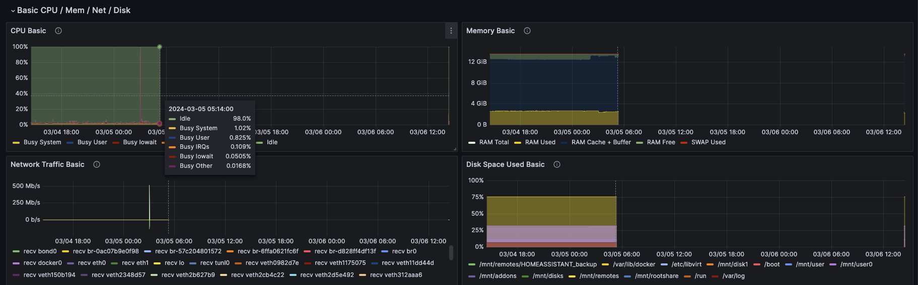

My server sometimes crashes and becomes unresponsive. Based on other threads, I had the suspicion it could come from video encoding. The test I did was to not start my docker container doing this and the server stayed stable for several days, then start it and it crashed after a couple of days.

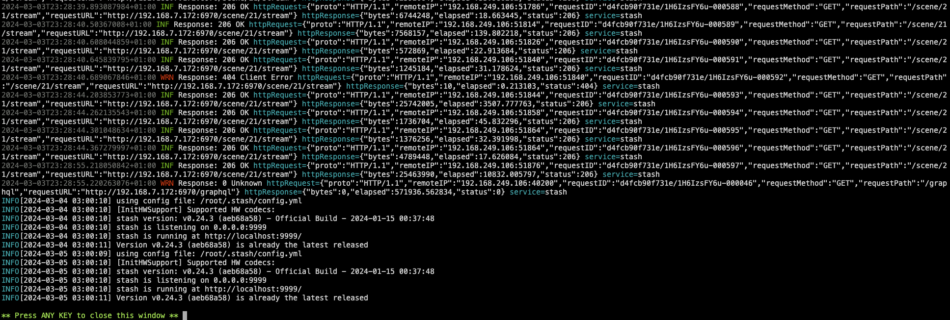

The video encoding software is Stash. However I'm not able to find a trace of a log that'd help me figure out what's wrong. I attached the diagnostic and the syslog (not seeing anything obvious in there), but I'm not sure where to go from here.
In this case, I don't have the exact time it started to become unresponsive but I suspect it was on Tue Mar 5 (coincides with when Grafana stopped logging stuff).
