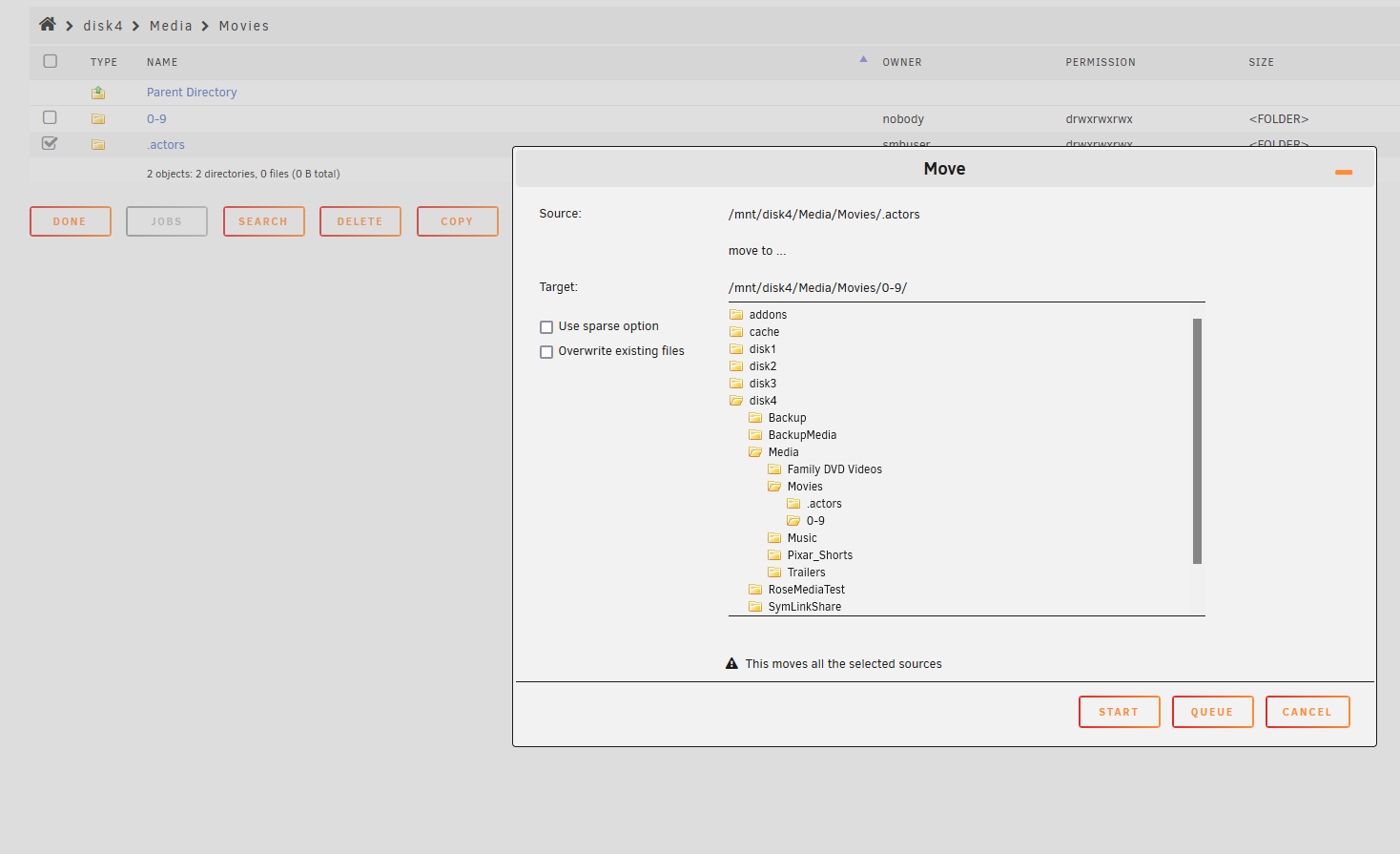

IF you install   Dynamix File Manager   and work at the disk level, you can do exactly what you want.  See below:
I just tested and it works.  Only the files pointers were changed.
