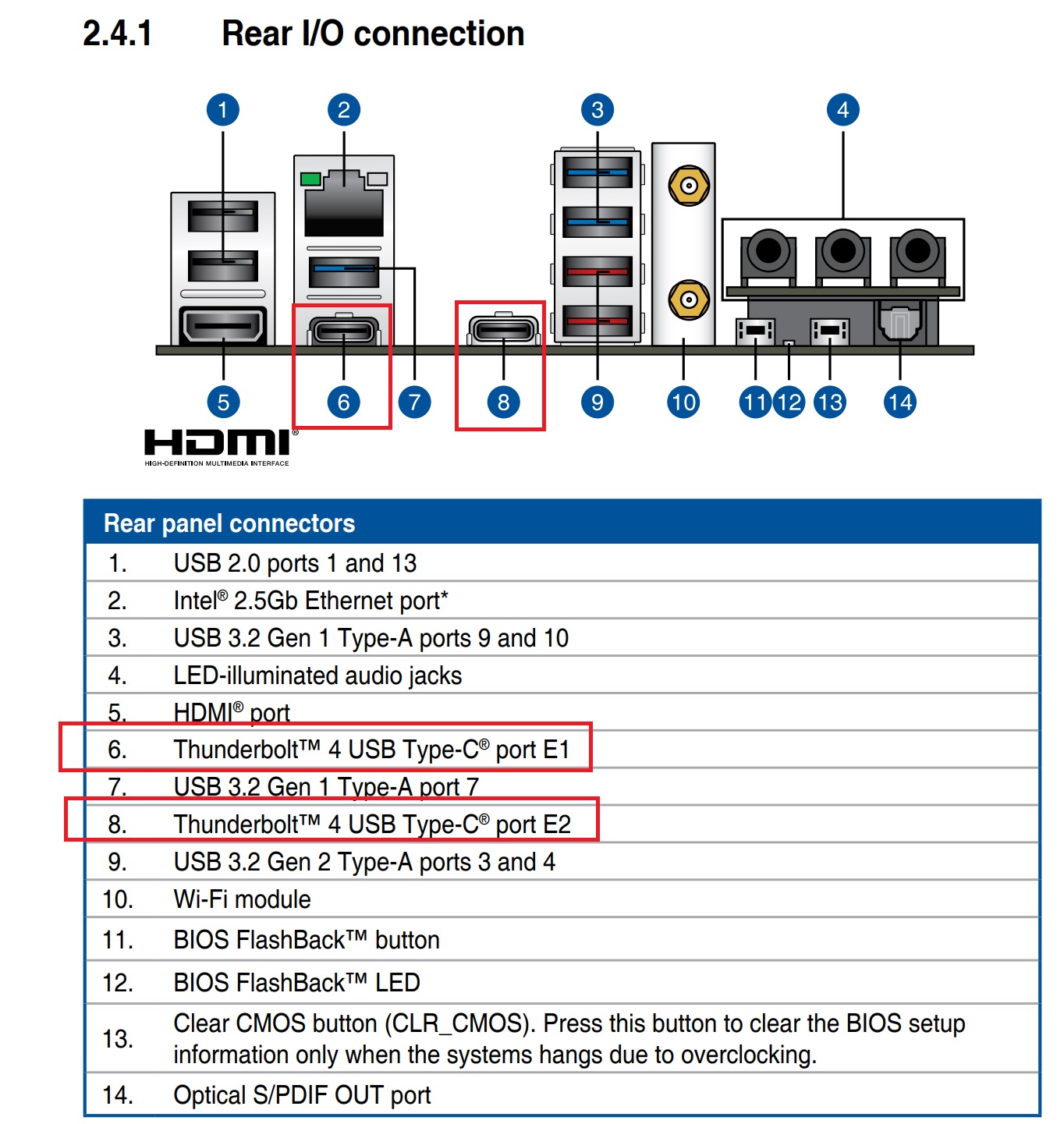

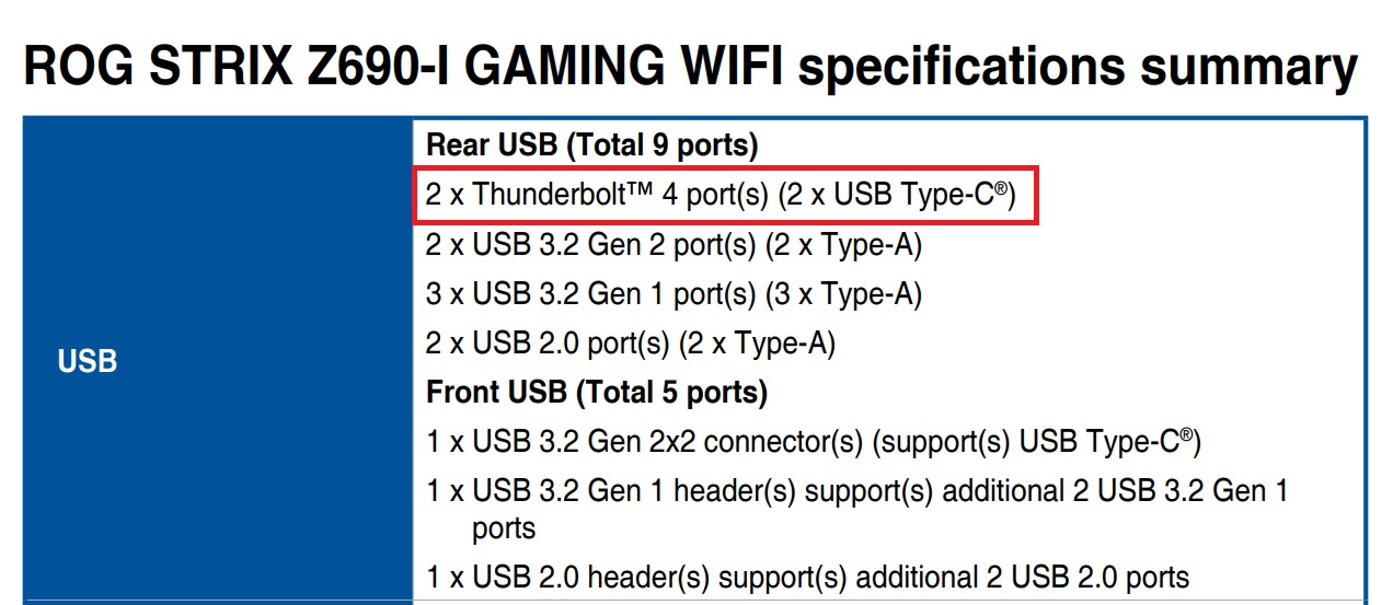

Here are screenshots from the Asus Z690-I manual for USB4/Thunderbolt:
It should work with just an MB replacement for Z690-I
