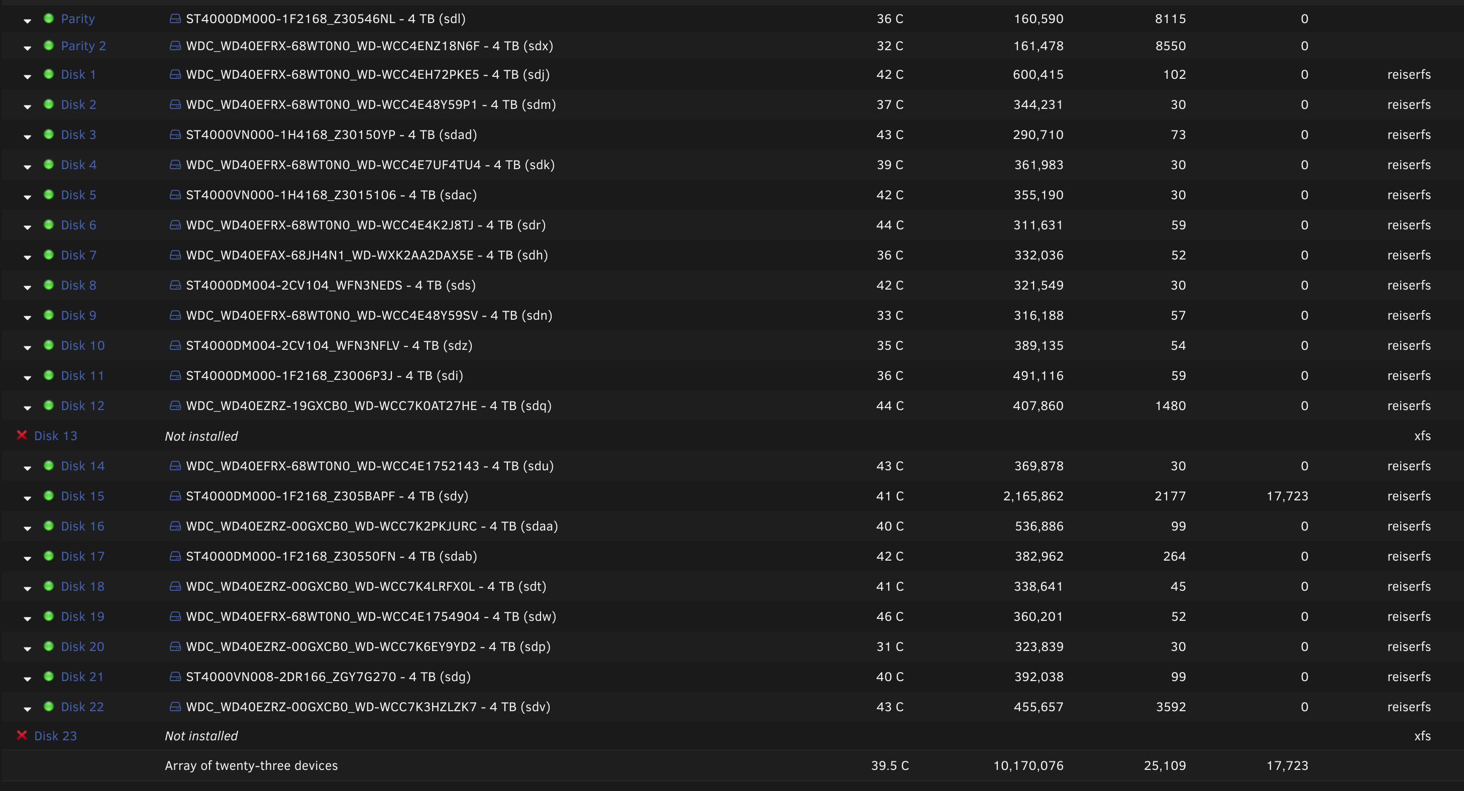

Disaster.... I think.
So, I had a dual-parity setup and I had two drives die. At the same time my engine in one car went and the transmission in the other (fun times).
I had to allocate the funds to the vehicles and was praying the other disks would hold up. Turns out, one more decided to flip out.
Now I'm not sure what to do as I can't seem to "fix" things with three, poopy drives. Is all lost?
Seeking some guru advice...
Your screenshot on;y shows 2 drives with issues?

in terms of the 2 drives that are showing as “not installed” what actually happened?   They should not normally get into that state without some action taken on your part.    Do you still have the disks that should be there intact?

I still have all the drives, the two are still "installed" and the thrid drive is the one with thousands of errors.
If I try to replace that drive, it tells me "too many bad or missing disks".

I had shut the array down, pulled the "erroring" drive (15) and put in a replacement, but it then told me "too many bad / missing disks" so I put the old one back in.

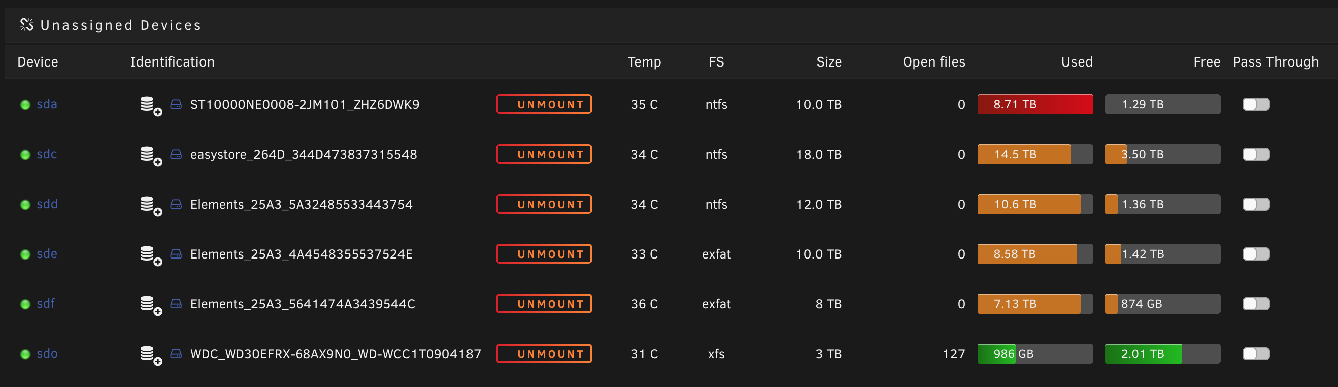

One of the drives showed in Unassigned now:
ST4000DM004-2CV104_ZFN0W6JK. /dev/sdae
This disk is not giving a full SAMRT report, check replace cables and post new diags after array start.
Is the other disk still missing? If yes you should also check/replace cables on that one.
Since you have dual parity, you can only have 2 disks needing to be rebuilt. You have to rebuild at least one of the other two disks before it will let you replace that third disk.

Not sure what you mean there. All disks are mounted, including the 2 "not installed"/emulated disks.
You have a lot of work to do with all those ReiserFS disks after you get your array fixed.
