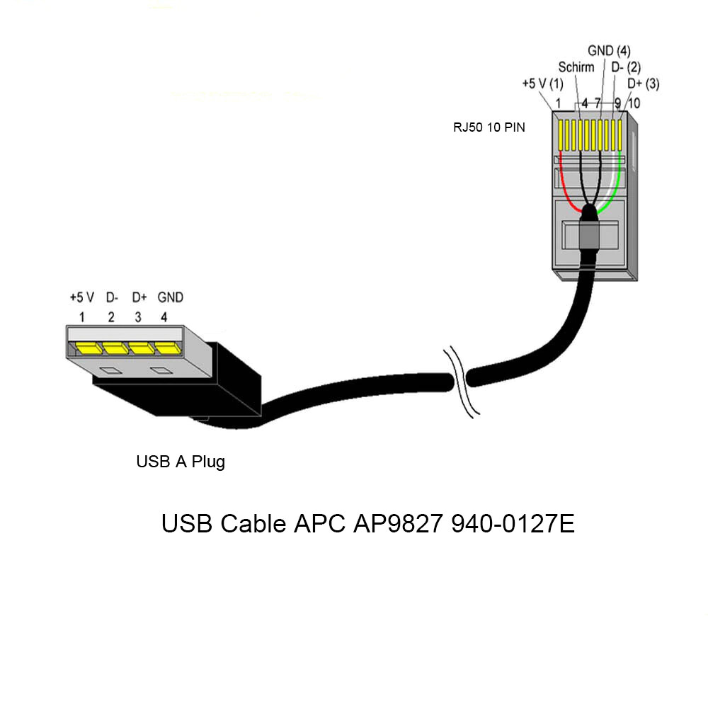

You have to make sure you use the right cable.
The cable that was on the box looks like that, are there variants of the cable that I should be concerned about? Also the cable from my old apc ups also looks like that (this was maybe 8 years old), and I also tested with that cable.
AP9827 is the most common cable and used by almost all APC UPS for USB - I'm pretty sure you have that one if it came with the UPS. But everything in this thread is guesswork at best, what we know for sure so far is that you tried it with two different cables (one of which is known to work with another UPS) on three different computers/OSes. That alone very strongly points to a fault with the UPS itself - I'm sorry I can't be of more help there.
